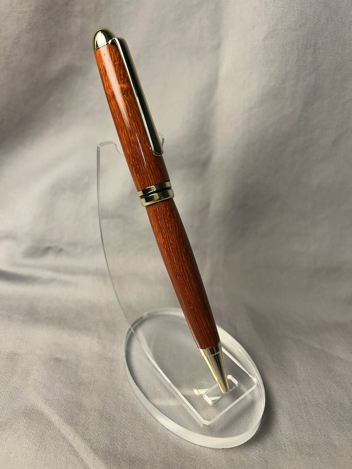

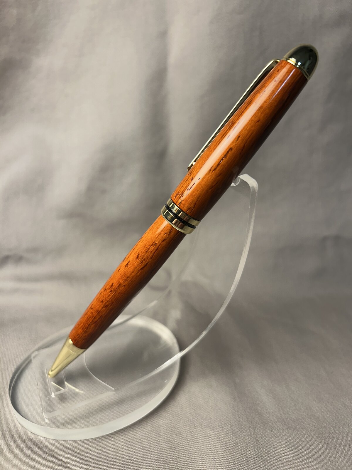

I have only used Pens Plus for finishing pens but recently ordered from Exotic and got some Gluboost supplies. My lathe only goes down to 500 rpm. I hand applied the fill (blue bottle) with 3 coats, then did 2 coats of orange bottle while lathe was on - she started smoking (LOL) guess heat is no good, got it! Sanded with wet micro set and polished with some car polish (another past time I have).
This comes out with much more gloss and this porous wood was itching to be my first victim.
Pretty excited over this one, as excited as a 60 year old can get😁

Very nice finish!
You mentioned it smoking? Were you trying to friction finish the CA or did it start to flash as you were applying it? I have a friend who is also a turner who lives near me who had a problem with his CA flashing. We spent some time one afternoon looking at how he applied his finish vs mine (both Gluboost) and discovered he was using a lot more than me. I use 3-4 drops generally per application on each pen segment, he was using closer to 10 drops and it was causing him trouble.

I was just applying it (not trying to friction it) Just have to do it quick, I must have been moving to slow. Blue shop towel, never stuck or anything.

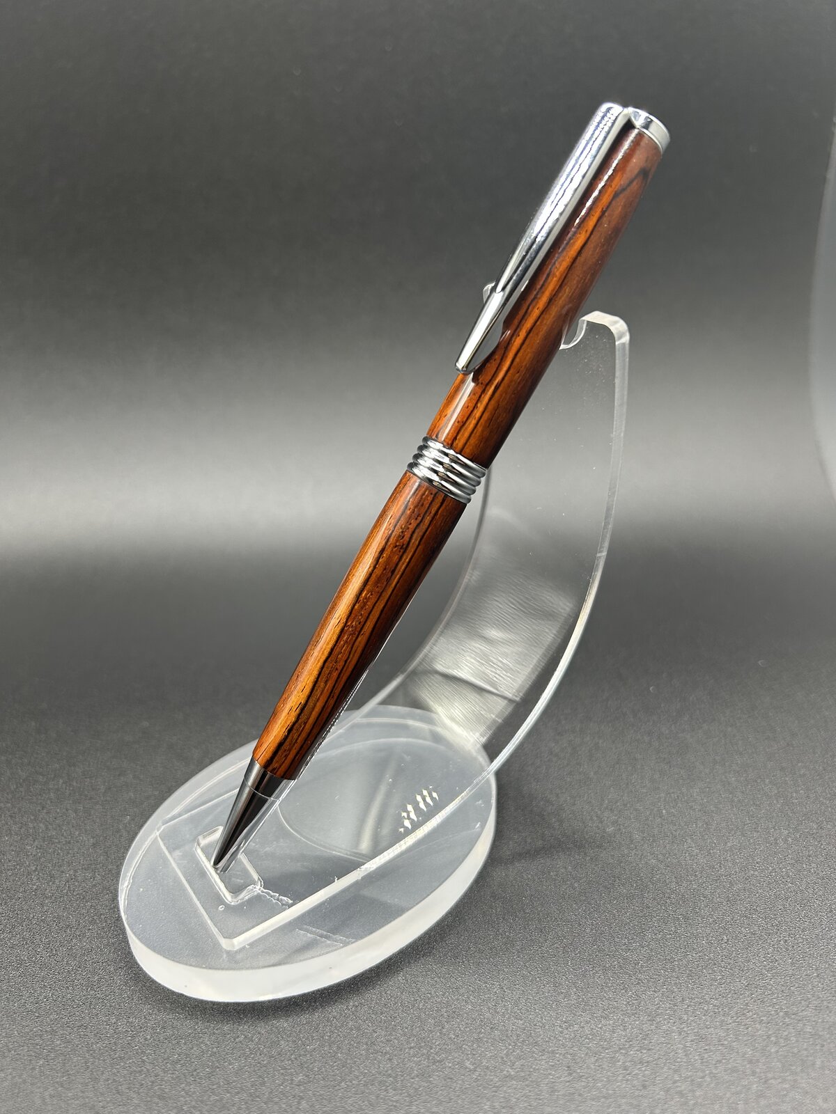

This Trimline didn't turn out as well as first, hey, I am learning😊 Bought a bag of these so perfect for my practicing

got it, your results look great!
