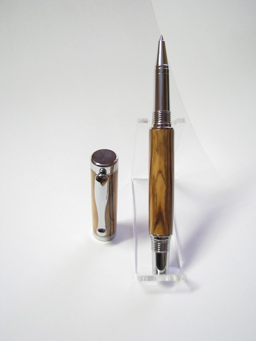

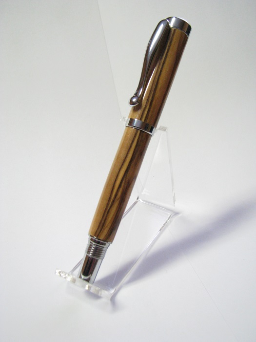

This is my first pen made from Bethlehem Olivewood. It's also the first pen I've made using the Atrax kit. I also purchased and used the parts from Exotic Blanks to make it postable. CA finish.
This is a going away gift for a very good friend who is moving away. We're both pastors and he's accepted the call to serve as the pastor of a church in Michigan. He already has two pens made by be, but this will be the nicest one yet. Tonight we're hosting a small farewell party for him and I'll be giving this to him then. Turned out so nice that it's going to be hard to give this one away!

BOW makes a great pen, and you have aligned the grain perfectly !! I really like the Atrax kit, too !! Outstanding workmanship !
That looks great.
