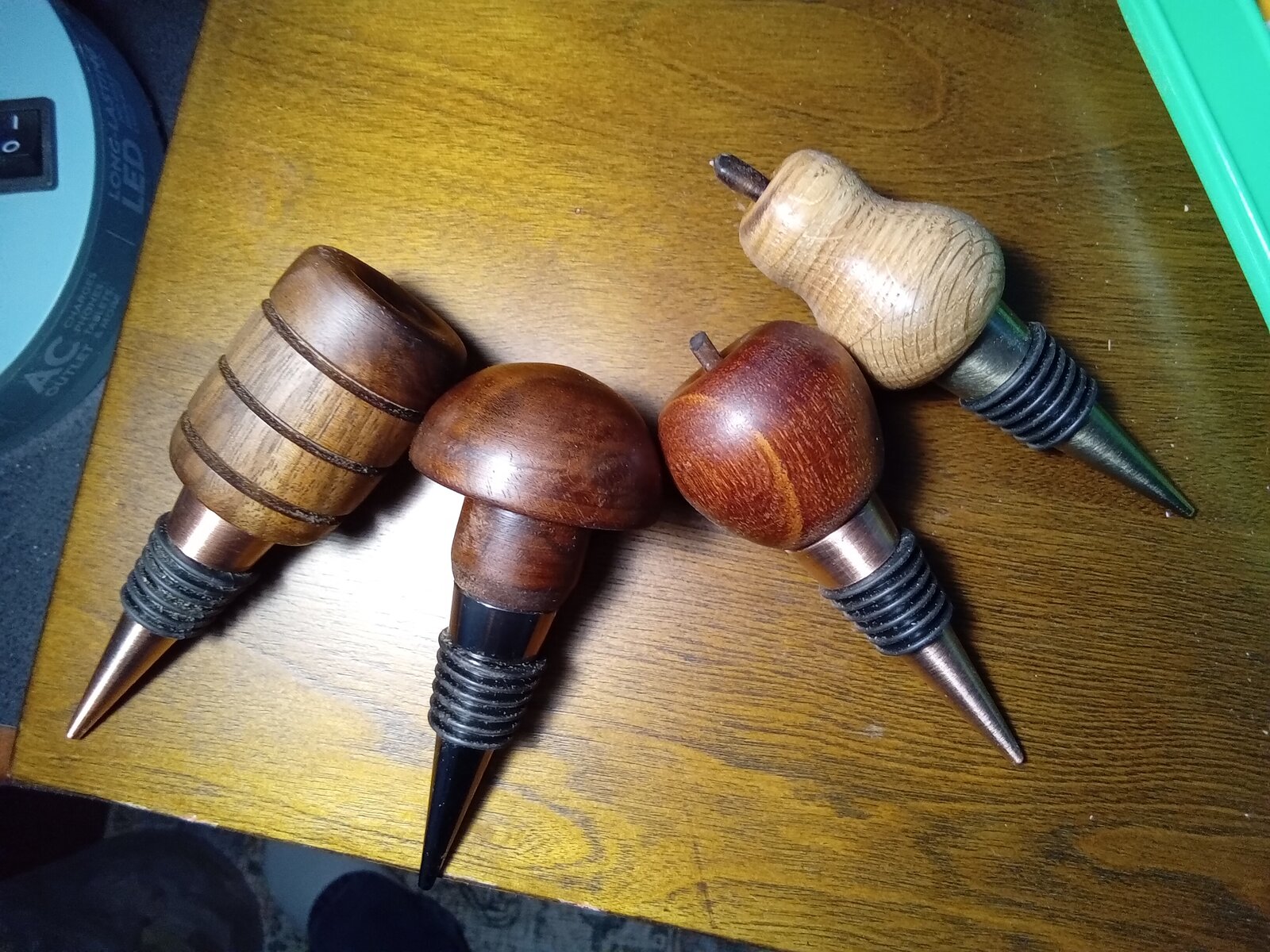

Decided to try the bottle stoppers and ordered a 10 pack and also a bottle stopper chuck system. Drill out the first blank and find out the mandrel/tap kit they sent is 3/8 but the stoppers are 8mm. Took an extra day to get the right size and make a mandrel, but here are the first few, Barrel and mushroom are walnut, apple is mahogany, and pear is red oak (both with walnut stems).

Those are very unique! I like the idea of using the pear and apple shapes
