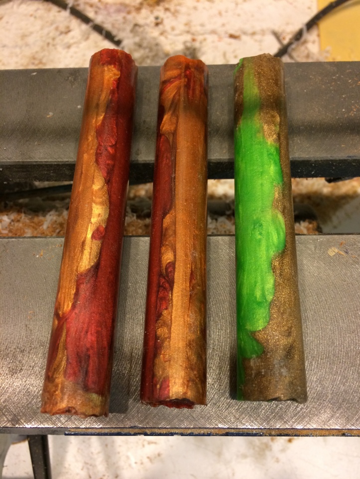

First blank making attempts
May 19, 2015
139
Columbia, Maryland
I have wanted to start trying my own blanks inexpensivly, these are just poly resin with pearl ex pigments.
I need to get better and swirling as I go.
We will see how they turn next, please ignore the messy station behind the lathe

how you made them?
Used the usual Castin Craft polyester resin mix, cut down and used 3/4 pvc pipe for my mold and regular corks for stoppers. No pressure pot, still building my setup for that. And basic Pearl Ex mica powders
