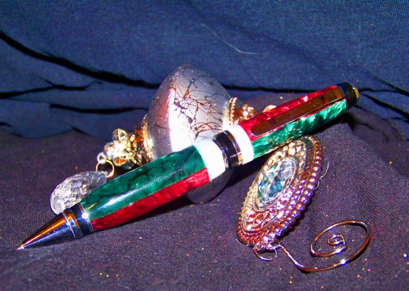

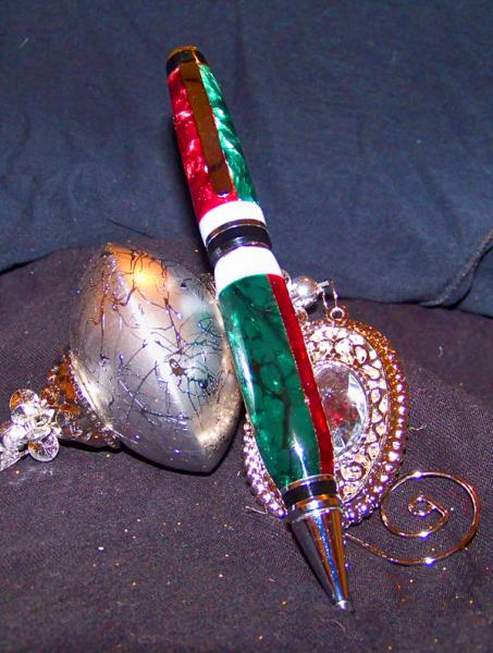

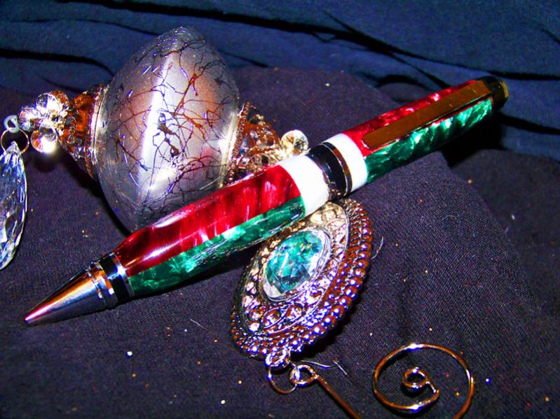

Okay so some of you have already seen this on the PITH pics thread but what can I say I'm excited! Here it is. Some of the pics are with the pen open and some are closed to show that due to sheer luck it worked that when open the red and red match and yet when closed the colors alternate. Wish I had thought about that prior to making it so I could honestly say thats what I meant to do but alas it was not. :) Happy it happened though! :)
