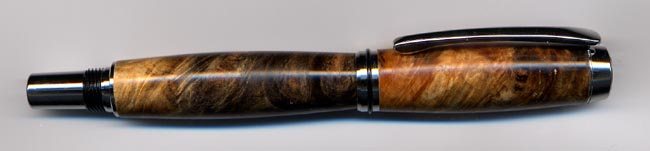

This is my first try at a baron,and I like it. The weight,balance and over all feel is excellent. The finish is lacking, could not get it to shine,sanded to MM 12,000 before the CA and sanded to MM 12,000 after the CA. Looks more like a satin finish. Any comments on the workmanship will help me in the future.

Nice pen..and I agree about the wood, it is very nice.

Very nice pen! I've done a few pens from cypress knee. If you are looking for a high gloss finish, you'll need a lot of patience. Mine usually take several coats of sanding sealer and at least 5-6 coats of lacquer.

I have used the auto compound/polish/anti-swirl (No.7) stuff to bring up the shine on a CA finish. Not a really glossy shine, but certainly better than not using it at all!
Once that is done, a bit of REN wax seems to help too.
