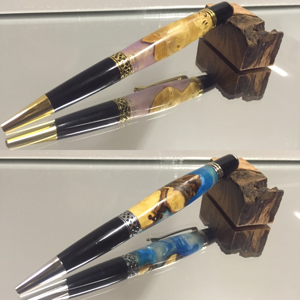

Have had these blanks for a few months but was unsure exactly how to finish them being wood and acrylic. Finally found some advice on here about wiping with BLO and then finishing with a CA application. I grossly underestimated the transparency of the purple blank and am a bit embarrassed at my folly as I am usually very careful to back paint the blank hole either black or a similar color as the blank. Have another one made up ready to go that I back painted the blank hole black. Will see how that one turns out!

How do you keep the color of the acrylic from bleeding into the wood during sanding and polishing? i've only done one and the wood ended up with a very blue tinge to it.
I was a bit worried about this too but surprisingly it didn't turn out to be an issue. I did my normal abranet 240-400, wiping the blank clean after each grit and sanding lengthwise after each rotation pass through the grits.
Wiped on a coat of BLO and rubbed it into the blank pretty good followed by 5 coats of CA and accelertor. Started in on my MicroMesh up through 12,000 grit and then high speed application of Novus 2 and 1 polishing compounds.
All sanding was performed at low rpm...around 500 in the opposite direction from which I turned the blank down.
Hope this helps!
