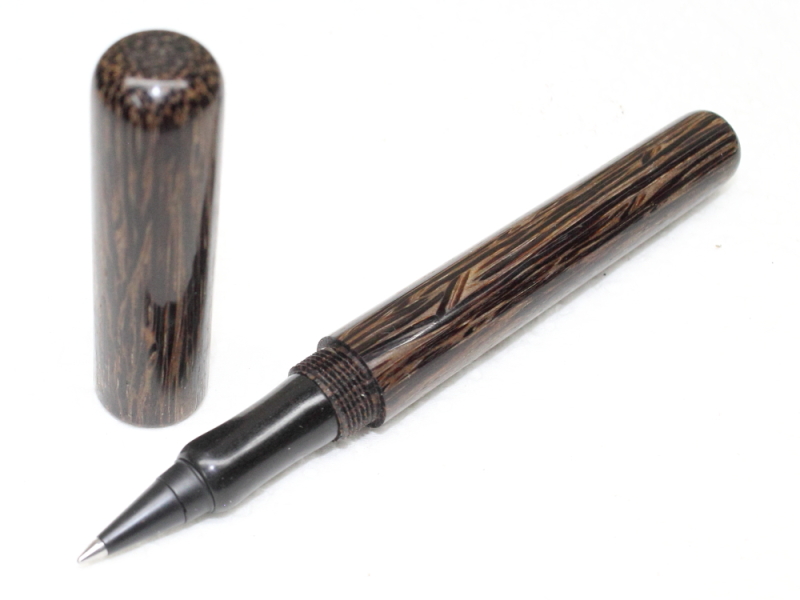

This was my first attempt at making threads on an all wood (except for the nib) rollerball pen. I received my thread mill cutter for the CNC and wanted to immediately try it out (it's a boy and their toys thing). Admittedly black palm is not the best candidate for taking threads but it was already rounded and ready to go.

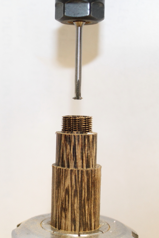

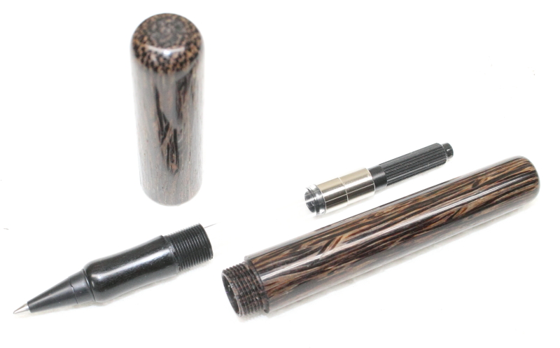

Ebony was used for the nib section because the blank wasn't long enough to accommodate it in black palm. M12 x 0.8 triple start threads for the body to cap mating. 3/8" - 40 threads were used for the section to body mating. M6.5 x 0.5 threads used for the Schmidt Refillable Rollerball nib. No taps and dies were used in the making of this pen. The thread mill cutter pictured below cut all the threads that are used in the pen. Using it, you are able to cut full depth threads very close to the shoulder on the tenon. There is no end to end play in the threads, so I have to believe they are cut pretty close to the tolerances listed in the Machinery Handbook. The threads fit and move great straight of the machine. When cutting threads with taps and dies (and maybe it could be the adjustment on my dies), I've always had to "work" them for a little while to get smooth movement.
You will notice an extra 1/2" tenon cut below the the M12 tenon. It is there for a purpose. To center the bit with collet chuck, I have a routine that "touches off" on the inside taper of the collet chuck on 8 differ points every 45 degrees around the circle. The X and Y values are recorded and the average X and average Y are called the 0, 0 coordinates. The routine runs at least 2 times and continues to run until the deviation between the current run and the last run is 0.001" or less. This could take up to 5 iterations to meet that criteria. The centering routine doesn't have to be run after each blank is cut. Many blanks could be cut but the routine should be run periodically. Anyway getting back to the extra tenon... because I know that the setup is probably not perfect. the extra tenon is cut and should be concentric with the threads that were just cut. This allows me to chuck the extra tenon up in a collet chuck and make the rest of the blank concentric with the threads.

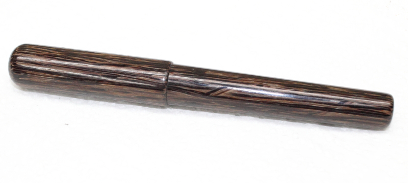

very nice Work. I like the overall look.
palm is actually a good choice when considering longevity. It is not wood and is very stable. Basically a 1:1 expansion ratio.

Thank you, Patrick! Not a lot of effort was put into the making of the shape. I did opt for a little taper on the body!

Mal, it is a 4 flute carbide cutter. Cost me about $21 + shipping USD from a supplier out of Oregon on Ebay! I run it at full tilt boogey 24K rpm at full thread depth single pass on wood. Feedrate in IPM is 30 or 40. The small bites it takes doesn't seem to melt the plastics at 24K. The first plastic I cut I went with 6K (the low end on my VFD spindle). If you're interested in the cutter I will get the link to the specific item I bought. It has a 3/16" shank and with reduced kneck can reach 1" inside a hole or outside on a tenon. If I recall the diameter of the cutter is 0.18" which allow me to also cut the nib threads.

Mal, here is a link to the ebay listing. The item seems to be out of stock at the moment but it gives a picture of the cutter outside of the router. www.ebay.com/itm/255128664942?ViewItem=&item=255128664942&nma=true&si=qZ84pbsrcwXMqwfnZa7N11G1Rqw%253D&orig_cvip=true&nordt=true&rt=nc&_trksid=p2047675.l2557
If you look at my picture all the way top you will see the ER-11 spindle nut and a 3/16" collet. Notice that there is a taper just below the spindle, here is where the 3/16" shank tapers down to a 0.115" neck diameter (I guess my misspelling of neck threw you off) Obviously a 0.18" cutter diameter will not work with a 0.1875" shank diameter and hence the neck. This gives you a 0.0325" projection of the v shaped wings to cut the threads. The manufacturer says that the TPI range of this cutter is 20-56.
Each helix of the thread in the triple start or the single start are cut at full calculated thread depth . I've been calling this a sharp v bit that comes to a point but apparently it must have a radius on the tips since the manufacturer is limiting the pitch range to 56 TPI, Anyway, on the M12 x 0.8 external threads I've been cutting at 0.024" thread depth and the internal at 0.020" thread depth. I could explain this further if you are confused by the difference in the depths. I like settings and to me the threads fit perfect, you don't have to work them a bit until they loosen up a little like when using tapped and died threads.
Also the threads are cut using a conventional cut (not climb). For right hand threads they helix down clockwise and left hand threads helix up clockwise.
