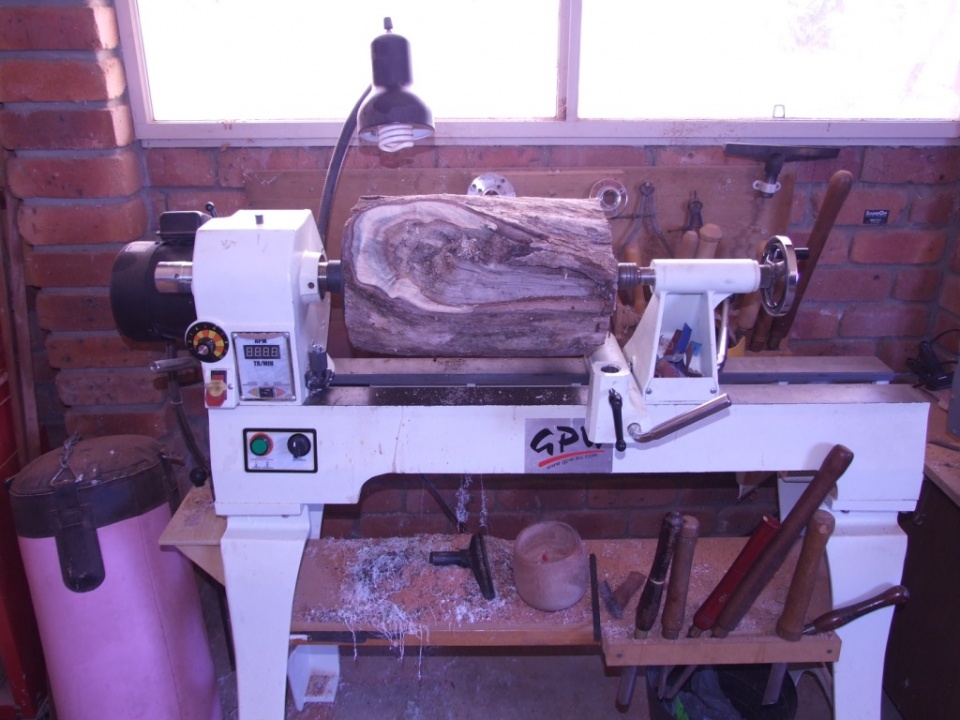

I trimmed the cracked ends and had a log 35cm long, totally out of balance due to a branch having grown off this bit and some rot. I turned the outside to nice profile deliberately keeping the entry large.

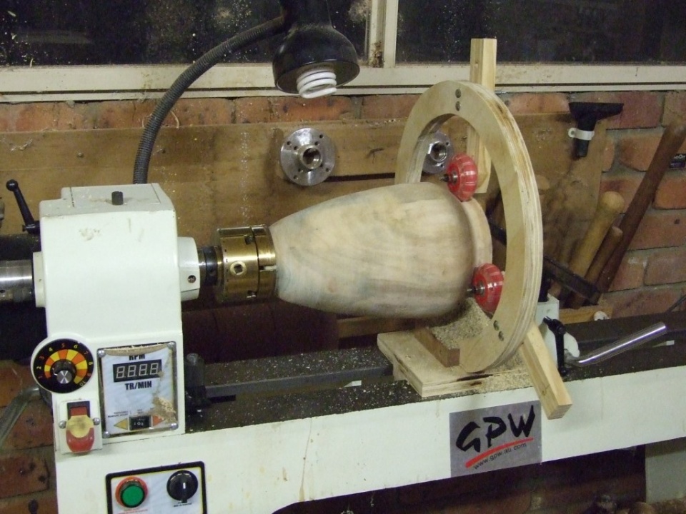

Then I had to stop to make a Steady Rest out of Ply and kids roller-boot wheels.

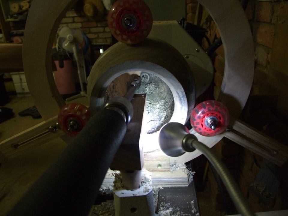

I then got the log gripped in the chuck, removed the tail-stock and installed the rest and set to with my old Exocet tool. I've had problems in the past using the Exocet but have learnt its all in the angle its presented to the wood, after quite a bit of mucking about adjusting the tool-rest height and angle I held the tool at I got it to cut very well, controllably and very cleanly - definitely worth persevering with !!! Its slow going but I got my walls down to about 10mm and quite even up to 5' deep, but then chatter and tool bounce started to set in, not unexpected really !!

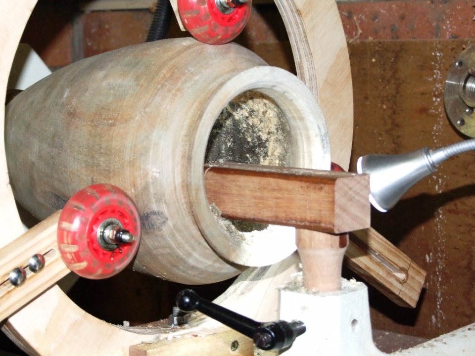

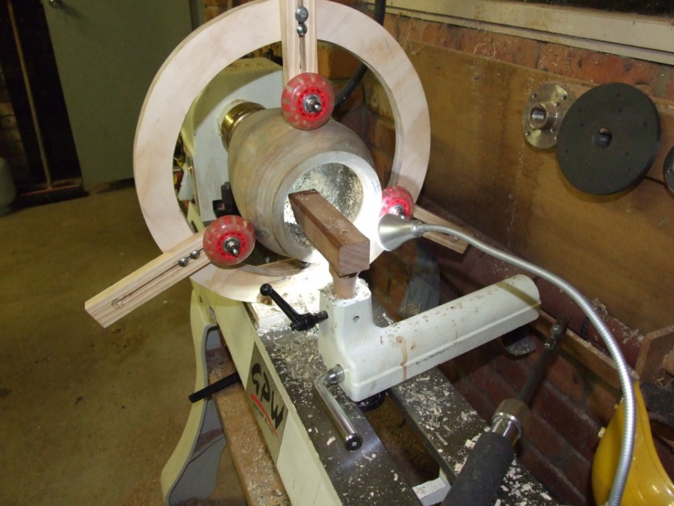

At this point I stopped and made an extended tool rest that reached in to a depth of 5', this helped settle matters down really well and hollowing proceeded ! However after about another 4' inches tool bounce and chatter set in again !!!
At this point I thought its time to trim the walls down before it gets too floppy !! So I stopped and made a laser hollowing guide - this is a wonderful idea and so simple. Just some 3/8th studding and scrap timber and a cheap laser pointer from Jaycar !
This makes judging wall thickness so easy and repeatable, I can see me using it on lots of projects !
I carried on with a bit more hollowing but really had to stop as it was becoming unsafe and the constant leaning and controlling the cutting forces was having to be done by wrist and elbow which was getting to be painful !!!
So I stopped, rough sanded the exterior and there it will remain as it is beyond my current skills, equipment and, I believe, unsafe to carry on !
