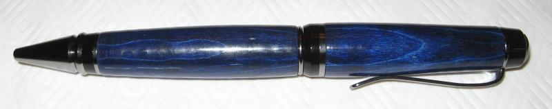

1.) Curly Maple Blue Dyed Cigar Pen
Let just say, I am kinda embarrassed to even post this pen. I think it looks terrible
This was my first try at a CA finish. I really wish I would have saved this piece for later, but I was excited to turn it.I learned a couple of things during this pen. 1. I had the lathe at too high of a speed for applying the CA. It cause the glue to bead up and make waves. 2. I was rubbing in the CA glue way to much. I realized later on, I was really only making the glue smooth.
Also, on this pen. The CA glue made the color wayyy darker than I wanted. Any way to control the tint of the CA finish?

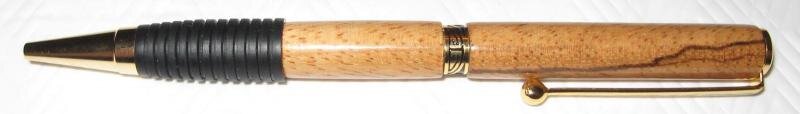

2. B&W Ebony Slimline
I really like this finished pen. I think its my favorite to date. I don't really think the images do it justice. I used the same steps as above, but I was using about the lowest speed my lathe has. The CA finish is a much more durable feeling finish. I am going to take this one to work with me this week and see how it holds up.
If you notice you can still see a lot of sanding swirls on this pen. I am not sure if its me or the wood. It showed up bad the last time I used B&W Ebony, but I don't really see it as bad on my other pens.

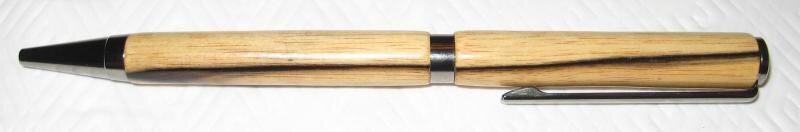

3. Slimline of some wood I don't know
This was my last attempt to do a CA finish for the day. (3rd overall) Its a kit that I got on closeout from woodcraft for $0.50. I bought about 10 of them. I didn't have any bushing or instructions. As you can see it didnt line up correctly.
I think i should be able to make it fit correctly on my next attempt.
Anyone know what kind of wood this pen is?

If that is your first attempt at a CA finish then I would say that you are well on your way. It's hard to tell from the photos, but you may want to spend a little more time wet sanding. AFTER you apply the CA, I would use "regular" sandpaper all the way to 2000 grit, which would be an automotive finish sandpaper. I would then pick the MM paper at 6000 and go to 12000. Then apply your plastic polish. The speed I use for finishing is about 800 rpm.
I've seen way worse CA finishes on my lathe, especially my first ones. Stay after it, you're doing well.

Doubt if the CA actually darkened the blue . It added gloss , which gives the appearance of a deeper colour .
Greatest improvement you could make is on your lengthwise sanding . To be most effective , this should be done off the lathe , which is a royal pain . After 600 grit you shouldn`t be able to see any tool marks or sanding scratches , even under a 3 diopter lens . If you can , you haven`t sanded enough . Personally , I apply CA after the 600 grit stage on any wooden pen , but I prefer a low gloss finish on wood .

You did well for your first time at bat. The two slimmies are very nice. The finish on them looks very nice as well.
As you know, the Blue Maple finish is flawed. It looks lumpy on the long tube and there are visible scratches on the CA. Sanding along the length of the tubes to help remove the radial scratches is great advice and will help a lot. I suspect that the "lumpiness" is a flaw of the CA finish and not the turning shape. I looked carefully at the turning profile and it looks good.
If you want my personal opinion, watch the Russ Fairfield video carefully and do exactly what he does. That will give you a great learning base from which you can develop your own style. I do mine a little bit differently but I started with Russ's method and it works if you follow it exactly.
CA/BLO is, I think, much more forgiving than plain thin CA. It doesn't get lumpy or form ridges and it requires little if any intermediary sanding (between coats). And you don't need as many coats to get to the same place as you do with thin CA. (At least if you do it my way you don't LOL!)
Indeed, I put on as much CA in three coats as you put on in a dozen. And it's smooth as a baby's butt after coat three. A very light micromeshing and it's ready to buff. Almost all the CA that was applied stays on the pen.
The other thing that will jump start your finishing is buffing wheels. If you want the pens to shine like glass... the buffer is the heaven sent. The Beall Triple buffer is inexpensive and easy to use. It has very high quality wheels and you get great results from it.
Your shaping of the cigar is very good so I think you are doing very well. If you had caught the cigar at the end of the initial learning curve it would have been really nice. It is nice now but it can be substantially improved. I think you know that which is why you asked for a critique.
