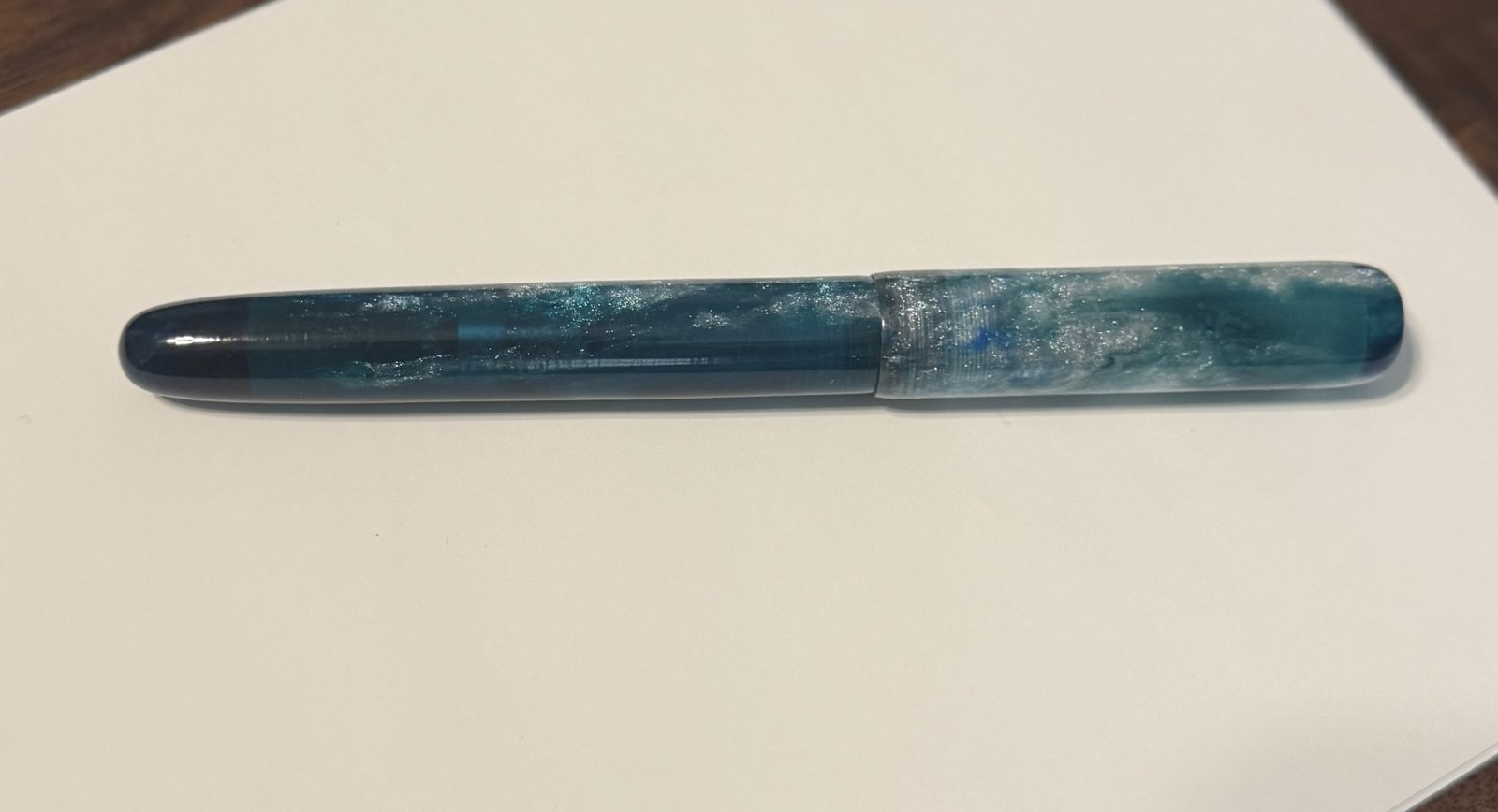

Which happens to use my first attempt at pouring resin. This was a challenge to complete and didn't turn out the best but I did learn a lot. I didn't want ro use my hobble creek blanks on a first try so I made a couple of my own blanks out of alumilite. I probably redid each peice once since I kept breaking pieces. Breaking stuff did help dial in my mandrels for the cap, body, and section though. I cut my own out of aluminum and it took a few tries to get a solid Mandel, that supported the blank while turning.
Nice job for a first pour and first pen!
The pour is really pretty, but as you can see, the resin is pretty transparent. If this was intended, great job, but if not, a good suggestion I got from watching Zak Higgins of Resin Werks Studio is to judge the opacity of your color by stirring with a wooden popsicle stick. Once you put your die or mica in, stir it good, then pull the stick out and see if you can still see the stick through the resin. If you can, the pour will have transparency, if not, it is opaque. Add more die or mica to the mix if it is too transparent until the stick disappears on the pull.
You can also get great swirls of mica and deeper opacity by adding a little colored opaque die into the resin, stir it in, then add your mica to produce the swirling effects. I typically use white to do this, but you can use other colors of opaque dye to build up the density, but adding the die first will cut down the transparency and not force you to overwhelm the resin with mica.
Keep working!!!!

Thanks, no the transparency was not intended. I used alumilite green die for the base and mica for the blue and white. I waited until each hit 100 degrees F and then poured. I stirred lightly with a brass rod but I was worried about stirring too much and didn't stir enough

I don't think the 'stir' when pouring would that greatly affect the transparency since you waited to a good temp to pour and if you are pouring Alumilte Clear Slow setup time is relatively quick minimizing settling of the mica. The pour temp will give you color separation and you got it, so the temp of pour was good. I do vertical pours, so sometimes the mica will settle out if you pour to early possibly giving you less opaque areas, but the vast majority of your opacity IMHO is from the base coloring. I would up the dye level in the base a bit and it will help get some density so the threading is not as obvious. Have fun!

Thanks, I'll keep experimenting with the pour. My cap is pretty thin too so I don't think that helped either. Cap is roughly 13.4ish mm wide and is tapped for m13. I used an 12mm bit to drill out the cap for the the tap. I honestly thought it was going to break but it's holding up. I could have used more base dye though. I think I used only a drop because I was thinking less is more
That's great for a first pour and first kitless! I have not ventured into that realm yet, but I do always learn new things with inexpensive materials. I look forward to seeing the next one
