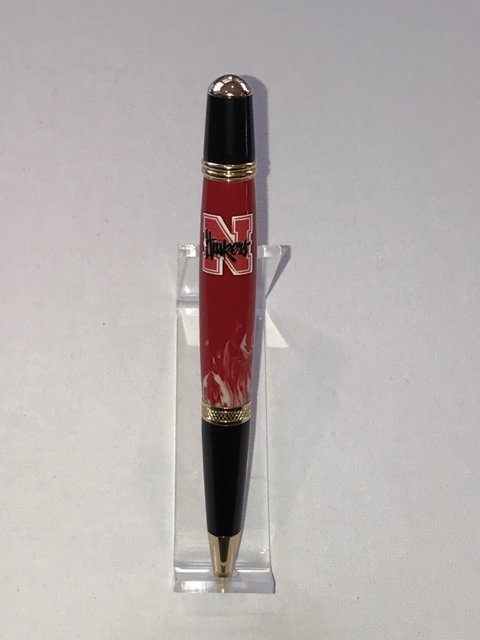

First time adding a decal... I little CA over the top but still the decal was scraped a bit on the left side ....
hunterdave99
Dec 1, 2016
44
South Korea
Great job. I didn't notice anything.
