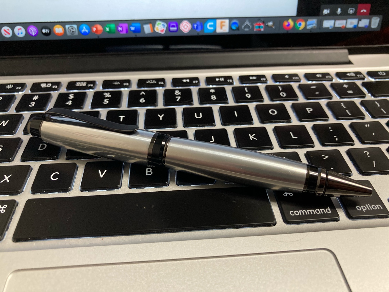

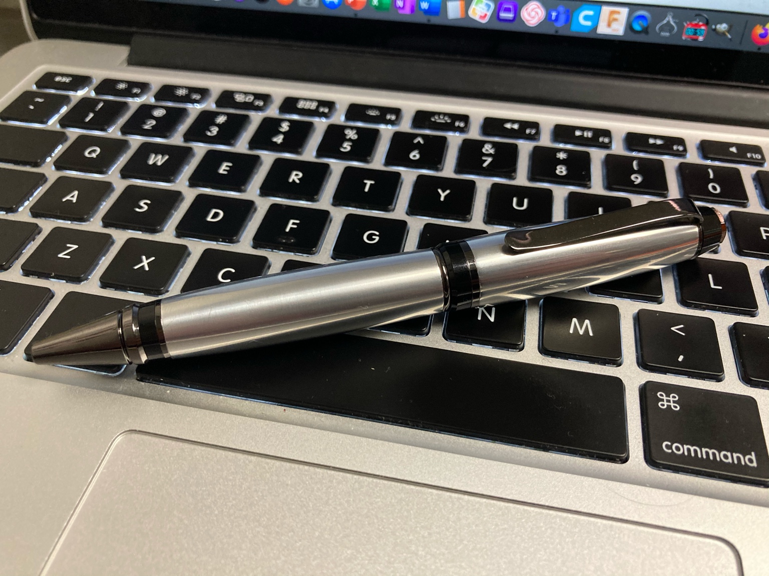

Inspired by the pen turners bible. I ordered some aluminum rod from amazon and made a cigar style pen using gunmetal parts. I really like the contrasting colors.
Question for those of you have worked with aluminum. Do you put any kind of protective finish on it? I have already managed to put a couple of small scratches on it. I foolishly put my keys in the same pocket as the pen as I walked into work this morning.

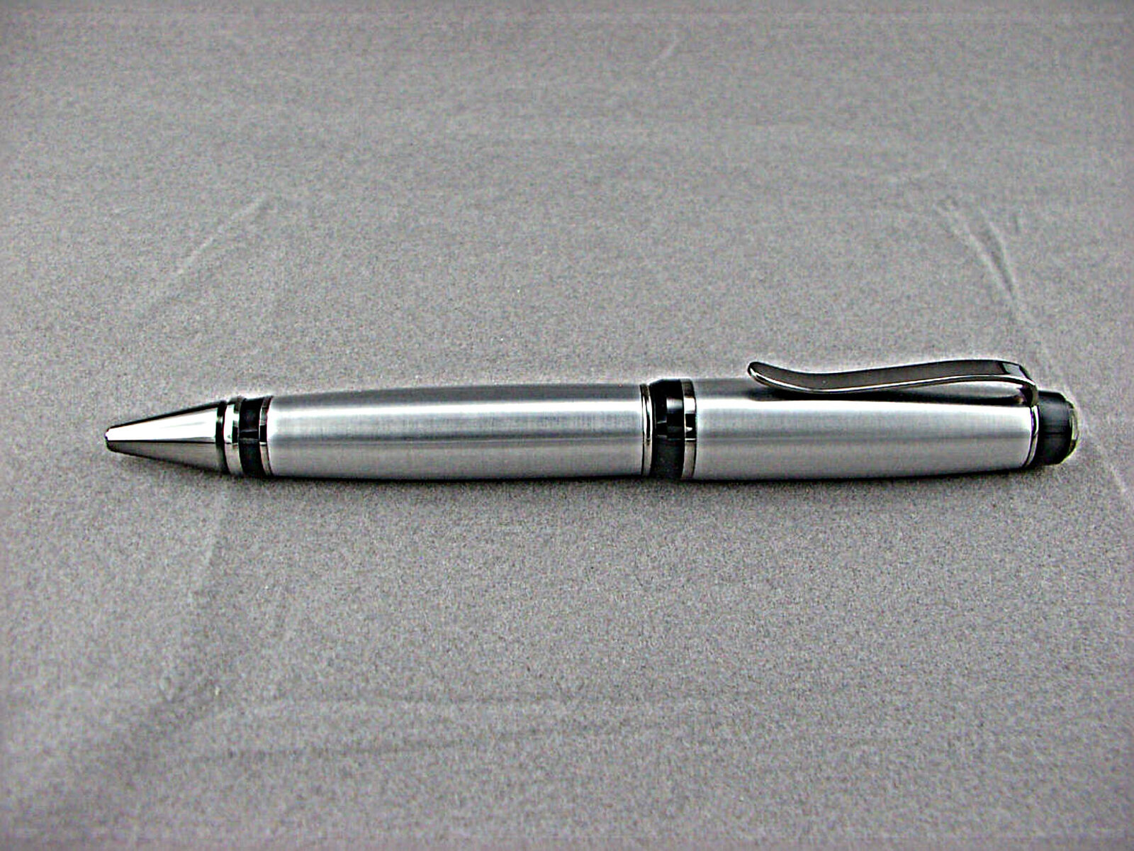

I made a pen very similar to yours many many years ago when I first started turning pens and put a brushed finish on it. I use it as my desk pen or at least one of them but it gets the bulk of the work. I have gone through many refills. It is nicked and has a few dents but that is character to me. Shows it gets used. Every pen you make will get dinged and scratched no mater what finish you put on it. I almost put a clear powdercoating on mine but chose not to. I chose the brushed look because it can hide a few of those scratches. Unless you use in an environment that is always protected pens will get abused. Nice looking pen and good job. Now I did include a photo of mine just to show the finish.

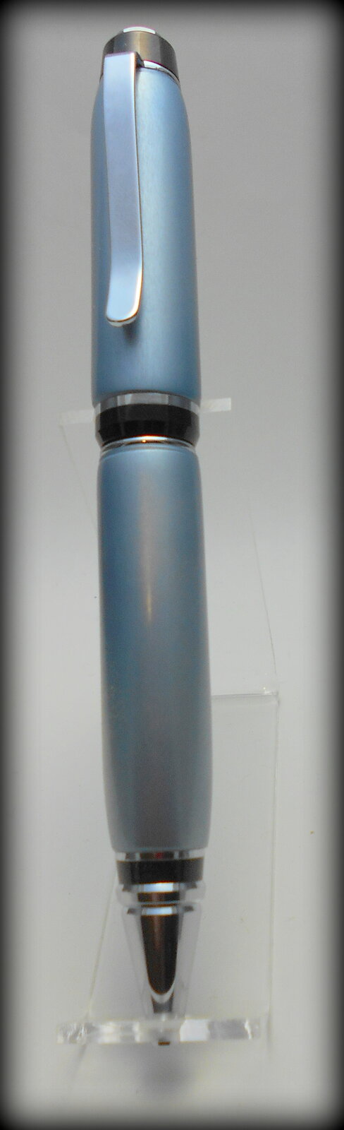

I anodize my aluminum pens. It makes an almost diamond hard surface coating and adds color. There is a good tutorial in the Library by Brad Gothard and he also has a few YouTube videos.
