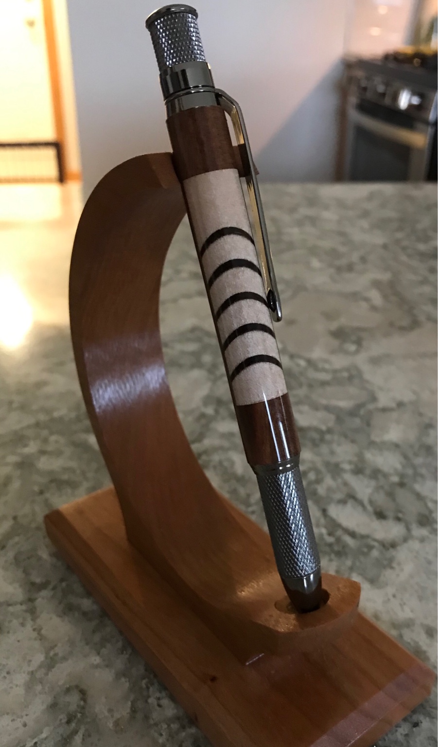

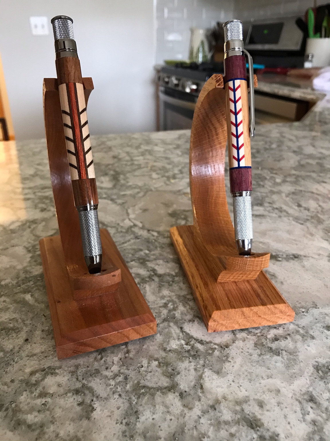

I've been showing a few blanks made with help of the new jig I built. Here are the first two pens. I figured I better actually finish a couple as sometimes, as you know, the blanks can look totally different after turning. Both are GT Knurls from Exotic Blanks. Woods used was, maple, chechen, ash, redheart , Purpleheart and blue and red vulcanized paper.

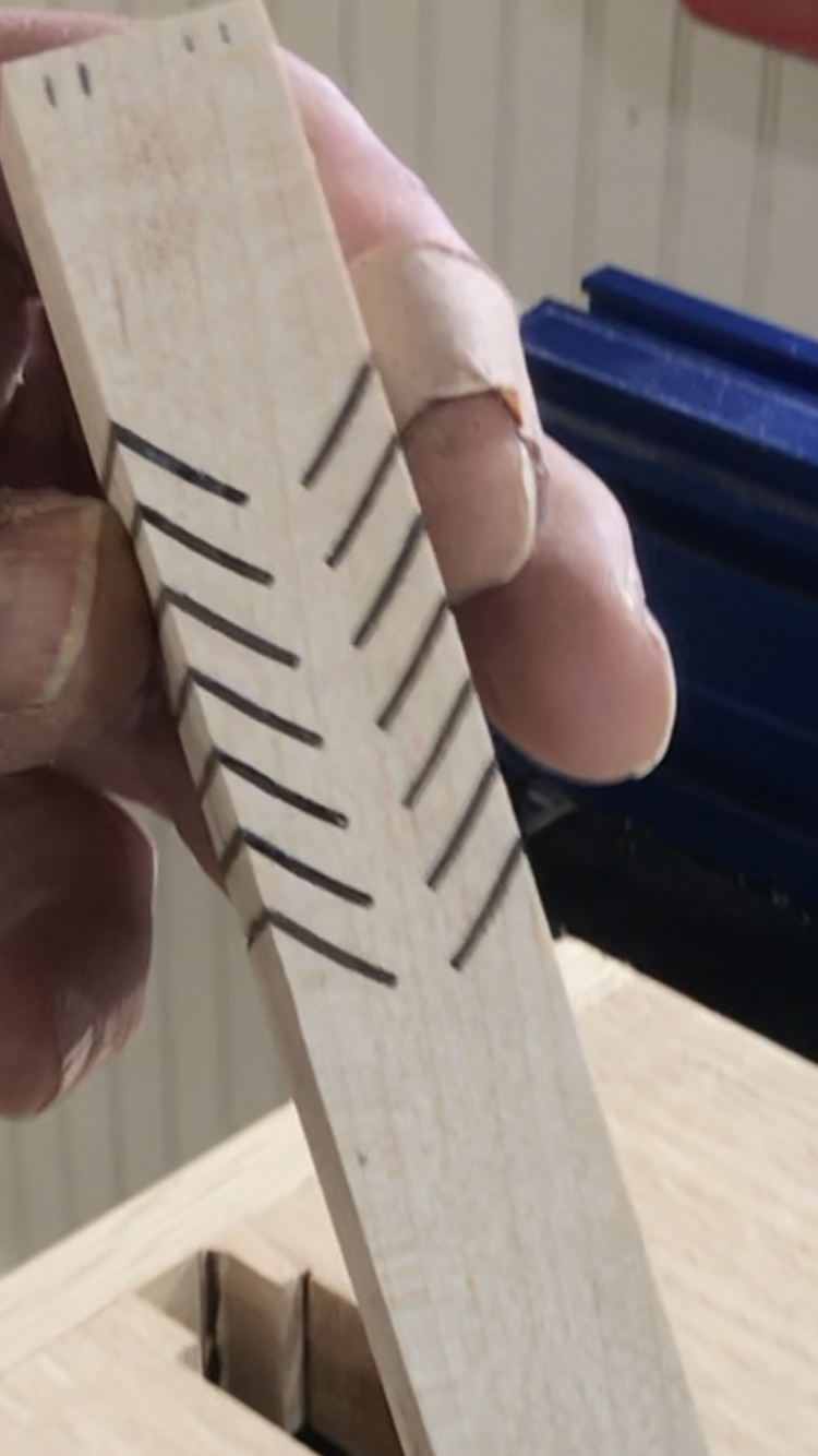

I really like those Ken. 👍 If my mind understands your process and the design/blank and on the left... the inserts will curve around each side? As your slots are cut through the entire blank (front-back), the match should be perfect, leaving only a good alignment with the ends of the blank as the last concern to keep a tight appearance. Correct me please if I am wrong

Thanks Mark. Here's a picture of basically the same cuts I made for the one your questioning. I just glued in the infill, cut down the middle, just to the inlay and glue in a new " middle". Since the cuts are the same, left and right, alignment is extremely easy.
You could cut a groove half way down the length and put in the inlay. When it dried repeat for the other side. You would never have any alignment issues that way. Or at least less talented imitators wouldn't. ;)

I can see that red and white pattern being transformed in a baseball like pattern. Nice work on both. Way out of my league.
I've never made the baseball themed pen that's out there, a little gimmicky to my taste, but I can see that pattern with the stripe in the middle also being red, fitting that kit nicely.
