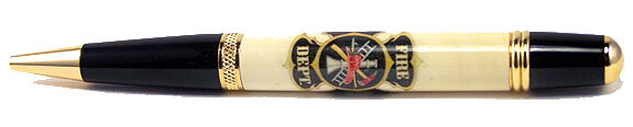

Not a clip but an alternative.
Nice pen, Larry !! Is that an inlay blank, or did you put a decal on the blank ?
I have several firefighter friends who "need" pens and I've been thinking of pens like yours.

oh and yes larry. i will eventually get into the labels. but at the moment i dont have the equipment to do it. But thanks for the idea larry.

Or contact someone who can do the labels and ask if they could sell/give you one (or a few, just in case), of those decals to apply to the pen just before you finish it?
(I would get as far as "first application of CA" and then pause to apply the decal and SLOWLY apply a second coat while turning the blank by hand, then give it about 5 minutes to set before continuing...)

Thank you all for your ideas. I have contacted Larry. He is willing to hook a brother up with a few labels. Thanks a ton Larry. And this will be my first label job.
