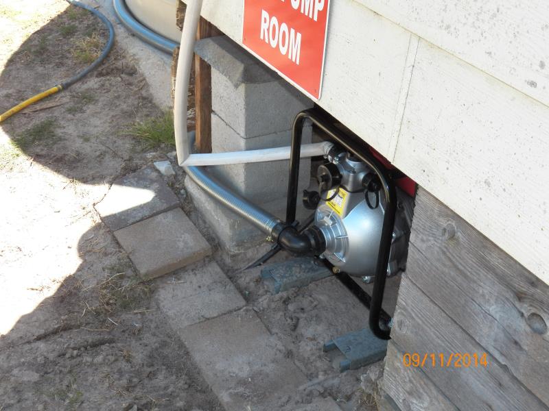

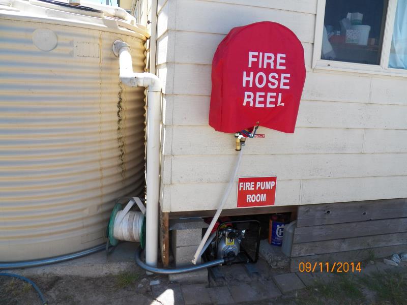

I have installed 4 1kg chemical dust fire extinguishers in strategic spots in the working area and lolly-shop however, these few months I have had a few dreams about a fire and knowing that my dreams always mean something, I started to get the gear I needed to set up a petrol pump system, connected to a 5,000 litre water tank.

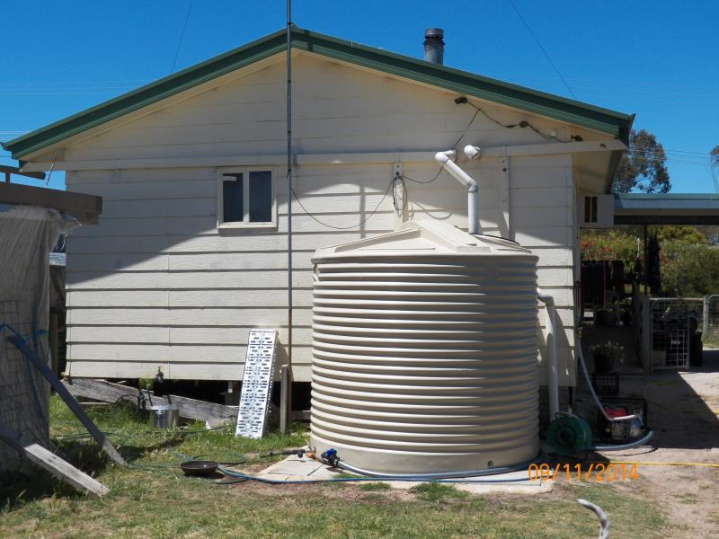

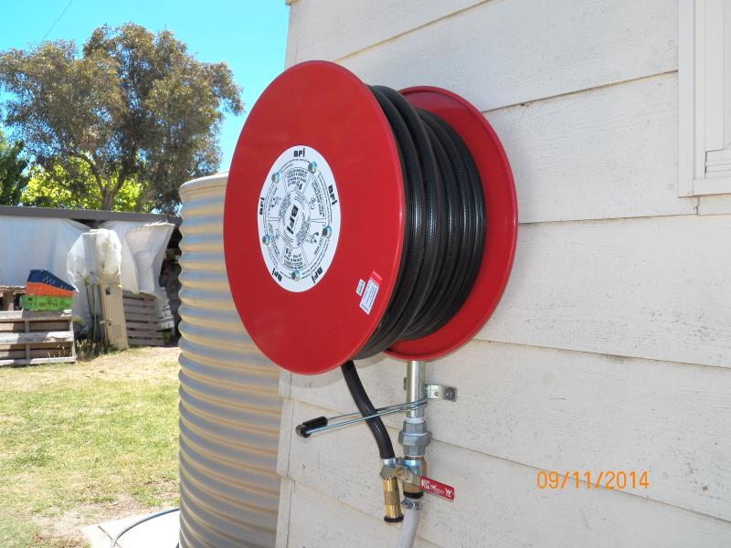

I got it finished last week, a few test did prove that the flat hose that come with the unit was useless in an emergency, these hose created far too many kinks and the water just can't get through until every one of those kinks is sorted, by then, would be nothing to save, it just takes too long before it can be used so, I spent another couple of hundred bucks, to buy a proper fire hose on a reel, the same ones you see everywhere in buildings.

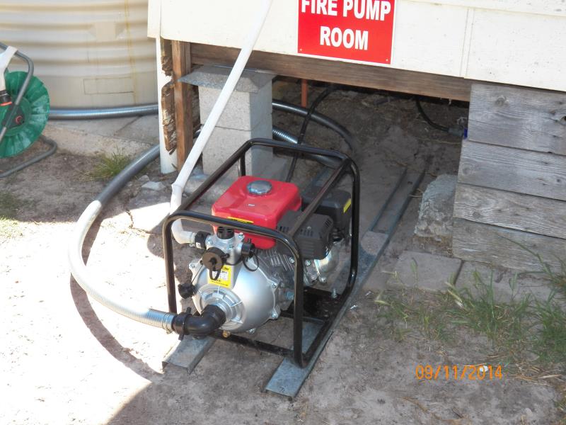

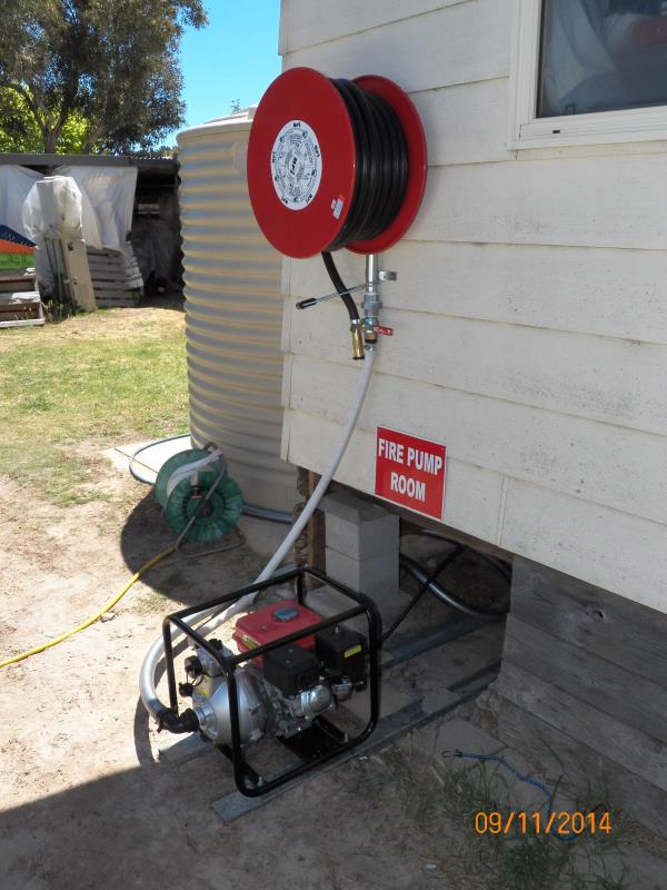

I manage to created a small area under the house and near the water tank where I could put the petrol pump, I used some metal U channel to make a sliding runner, making it easy to get it out in a hurry, far enough to access all areas of the pump, including the start cable.

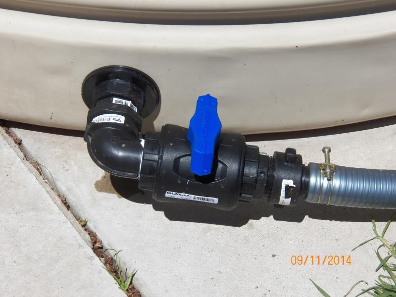

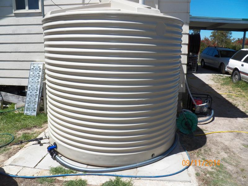

Everything is connected, the only required is to turn the water tap at the tank and the gravity feeds the suction 1"1/2 hose and bleeds the pump immediately so, the only thing I need to do is open the fuel tap and pull the starting cord. The hose, still on the reel, will feel with water as soon as the tap from the pump to the reel junction is turned on and from there, I can start walking with the hose nozzle end in my hands and adjust the required water flow depending upon the distance and the flames strenght. There are 36 meters of hose on that reel, enough to cover the back fence and a few meters over...!
The house bottom wood/boards skirt, already had an opening/door at the pump location, I will make a new door and I will need to replace the hole wood on that skirt, is all pretty rotten, particularly on the sides where they get most of the weather so, that will be done but the important stuff is done and that is what matters at the moment.
I hope that I never have to use it for real however, I will be running the full system every couple weeks in Summer time, to make sure everything is in perfect working order...! Unless Mr. Murphy come along and stuff me up on the day...!:mad:

Do you have a local tax, yet, on collecting of rain water? :smile: That is a nice setup though. Not sure if I would leave a creased bend on the hose going to the pump like it shows in the 2nd pic in on the top from the left
Well spotted mate, that is indeed a short piece I cut for the 30 meter hose that came with the unit. I needed something very flexible there and the only thing I had what that flat hose, that and as I said, is totally useless, it won't be there very long as I ordered a equally flexible water hose that don't crease/kink.
The pump when extended will improve the crease on the hose, not totally but enough to let water pass through so, I know that, it will work if necessary, before the new hose gets here. Small towns don't normally have stuff that is out of the norm, you always have to order or drive a long distance to go to the city...!
I was trying to work out what you meant with the tax for the rainwater collection and , was then when I remembered to have read something about it, somewhere but not here. If you own the property, you can put as many water tanks of any size as you wish, most people around here have 2 or 3 an bigger than mine, I rent so, I have to accept what is in the house that in this case, had a small galvanized 1.500 litre water tank that was pretty rusted so, when the water started to come out everywhere, a new tank was required and I offer to install the new tank if they would supply a 5,000 one, any bigger and would be a bit of a problem with the septic tank access...!
