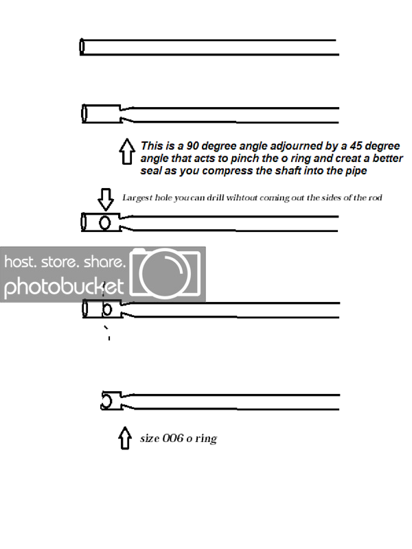

Here is a diagram of the rod and also a final parts list for supplies needed:
Supplies:
1/8" x at least 4" Brass Nipple
1/4" Brass or Steel Rod ( i use steel because it was more readily available and is a bit harder than brass so hopefully it will last longer...)
Size 006 O-Ring
1/8" End Cap for the pipe
Sealant for the pip and end cap. i just use Teflon tape but they also say you can use a bit of JB Weld (untested)
Optional:
Lathe with Jacobs chuck capable of chucking 1/4" rod
Lubricant
45 degree triangle file
Wood to encase the part with
A kit pre-made from certain individuals that sell them on the forums and if they would like to offer these please post here on this forum but do not advertise like a classified...
!!!Necessity!!! The key is a good tinder! I use homemade flint cloth that is just cotton jeans or an old shirt places in a tin can (Altoids can ) then places in a hot fire till the material is black and catches a spark well.
I am heading out to the shop now to try to get some pictures so ill post them asap... and in-case i didn't answer any of your guys' questions, let me know!
