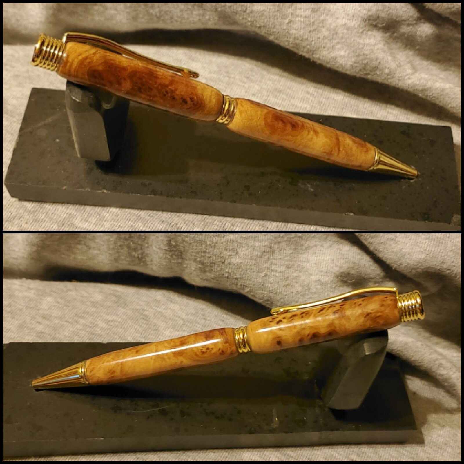

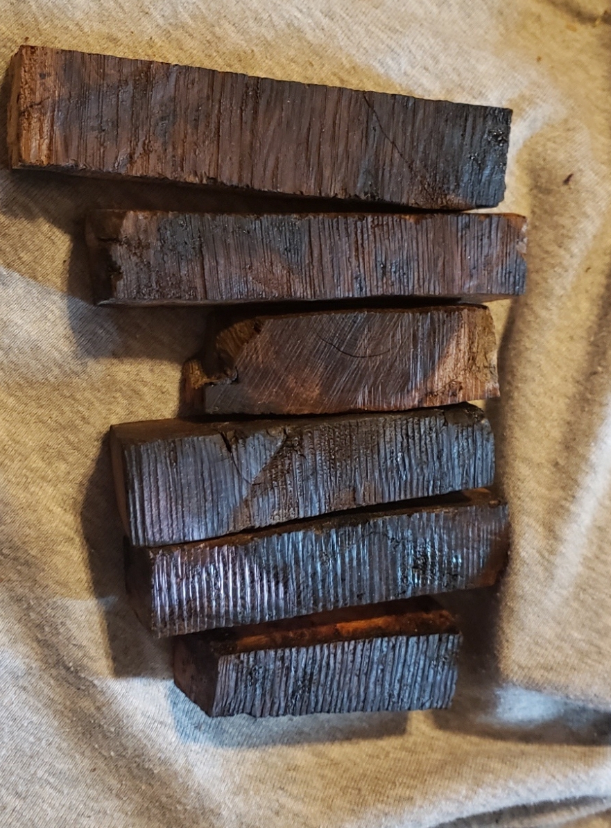

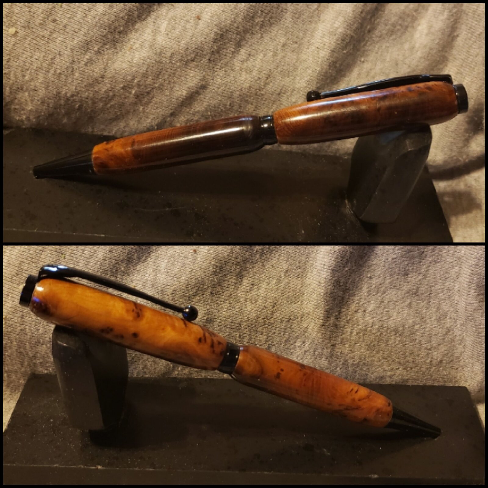

So I bought a little ponderosa pine burl and cut it up. I took 1 blank and turned a slimline right away out of some small leftovers. The rest went into the oven to dry out so I could stabalize them. I was turning a few pens when my wife came in and said it was really smoky. I hadn't noticed because I was in the "zone". She looked over where the oven is and screamed as flames were quite visible. I ended up turning 1 of the burnt ones to see how they would look. We figure the temperature control malfunctioned, as it had only been maybe 15 minutes at 150 degrees.

I've used the food dehydrator method also. It will get you down to about 3% MC (based on my measurements). Less risk of the roasted effect, but I think that added a nice design element in your case

Thermally processed wood is a product being made and sold for its bug proof and weather resistant properties. From what I can tell they are only using a few species of wood. No reason other species couldnt be done this way, you just found a diy way that needs a lot of refinement to avoid the flames.
