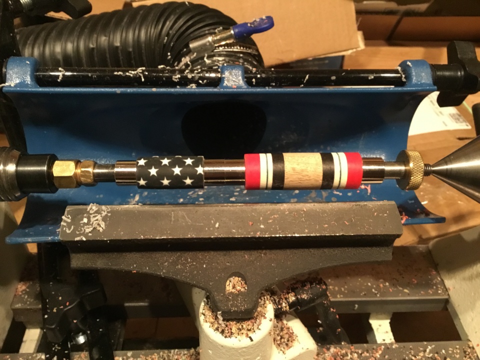

So I'm trying to make a pen for a friend who served as part of Operation Iraqi Freedom back in the day, and I made a blank modeled after the OIF service ribbon from myrtle, holly and ebony with a red acrylic (I've tried to attach a photo of what I've turned so far).
My question: would you advise a CA or other type of finish for a mixed segmented blank?
I don't have much experience with finishes except for CA, but I have not applied CA to acrylic - preferring just to micro mesh and apply plastic polish. Also, I'm pretty sure that I have developed an allergy to CA that results in unpleasant cold/sinus symptoms for a day or two. But I just got a respirator with the charcoal canisters so I'm not giving up on CA yet, if that's the best finish for this blank. Appreciate any suggestions! Thanks, Russ

I like what you have segmented together. I will give you my thoughts because I have segmented some of those woods together and will tell you they will bleed into each other. Here is my way around that problem. I would turn the entire blank with either carbide or a skew or combination and never touch the blank with sand paper. As soon as you start sanding the ebony will bleed into the holy and you will add scratches to the acrylic that you will see when CA over. The stars you do not need to CA because I assume that is all acrylic but if not then same applys to that blank. Yes you can CA over acrylic and in fact that is about all that will stick to it.
Now when starting the finish with CA you need to lightly touch the blank in one sweeping motion and do not rub back and forth with thin CA to seal the blank and keep from smearing the wood colors into each other. It does work.
If it were me I would have chose all acrylic or all wood. Mixing medium like that opens yourself up to different expansion movement. To avoid ridges between the wood and acrylic again the skew is your friend. Those materials turn at different hardness levels so be careful.
Again this is just my opinion. Others may tell you something different. Good luck.

IMO - Yes, a CA is probably merited here.
As mentioned tool skills are crucial to avoid/minimize cross contamination between the ebony and Holly; I fully agree.
However, with care, success is on your side.

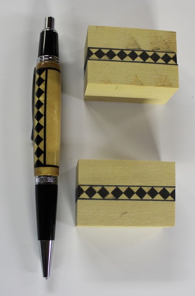

This pen blank is Ebony, (not sure of the specific one, but very dark) black veneer and Yellowheart. The Janka hardness of the yellowheart is similar to your holly; both being less dense than any Ebony. The blank was turned with a Magical Skew (a carbide on a 45 degree angle to allow a shear scraping effect) and the grit for sanding started probably around 320 or 400. (I constructed the blanks, EBorraga did the turning). I believe there was 3-4 coats of CA used for the finish.

Thank you both for those suggestions! I've read quite a few posts from both of you in other forums; I value your experience and really appreciate your time answering my question. CA on the lower blank is what I will try. If the pen turns out well I will post a photo in a different forum and see what you and others think.
I get the expansion/mixed media observation and prolly didn't think that through enough. I would have liked to use all wood but I couldn't find a wood blank that was red enough to emulate the color of the ribbon. I'll just have to give my buddy an extended warranty!

No problem Russ it should work if you are careful in the turning. As Far as red wood goes. Bloodwood is the redest of woods but it is a deep red. You could always go the dye route on softer woods such as maple or pine. Good luck and look forward to seeing the finished pen. :smile:
