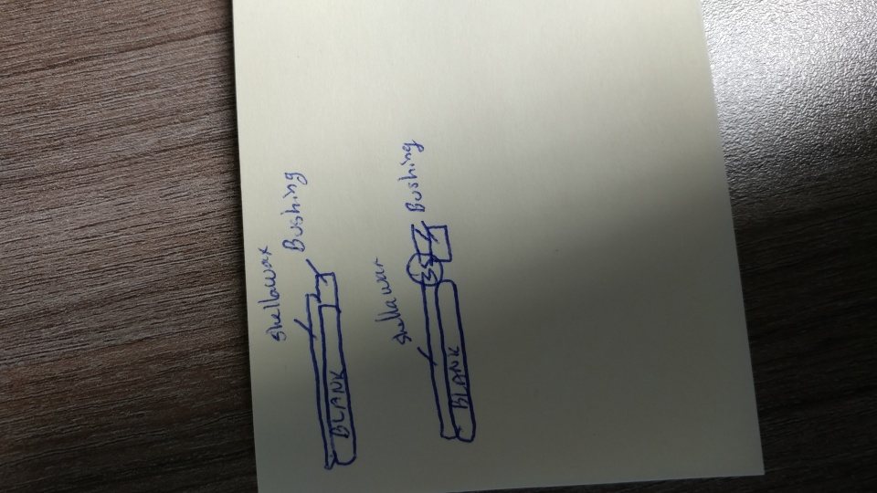

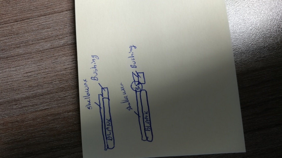

I tried to put like 10 coats of Shellawax on my pen. The problem I had is that there's an "accumulation" of the shellawax at the junction with the bushing. When I removed the bushing, I had to find a solution because there was shellawax at the end of the penblank. I took my nail, but it removed a bit of my finish on the blank... How do you proceed to remove that over shellawax or to resolve that problem?
It would seem that you are not sanding your blanks square to the brass tube before mounting on the mandrel. If there is ANY GAP AT ALL your finish will find it's way in there ... This is something basic that you are going to have to work out BEFORE you start trying things like a CA or lacquer finish, as those can literally glue your barrels to the bushings.
In fact, I've used a pen mill cutter to square my blank.
I made a drawing to show what happened. Sorry, I'm not good in drawing....

But how can I remove the over of shellawax when I separate blank from bushing.
I understand that I have to change my finish type...
A simple way is to lay a piece of 320 or 400 grit paper down on a flat surface and carefully, being sure to keep it perfectly flat, drag the end of the blank across it.
A more precise would be to mount a disc sander on your lathe, chuck a correctly sized punch in a drill chuck on your tail stock and gently sand off the excess finish. BTW, this is a much more controllable way to square your blanks as well. A pen mill can easily "eat" a brittle blank.

HMM ..... how in the world would you get that to happen? The shellawax just pushed your bushing apart from your pen barrel as you worked???
You should have that tight and secure on the mandrel, so that should never have been possible. It's a very puzzling situation, the only thing I could think of was that you didn't have the barrels squared to the brass, but if you did I have no idea what makes that happen.
