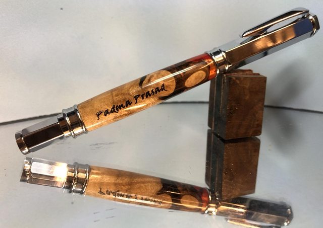

NB: I Made a pen for a friend who became a US Citizen. Ken Nelson Kallenshaans Woods engraved the Pledge of Allegiance on the cap of the US Flag themed pen.
