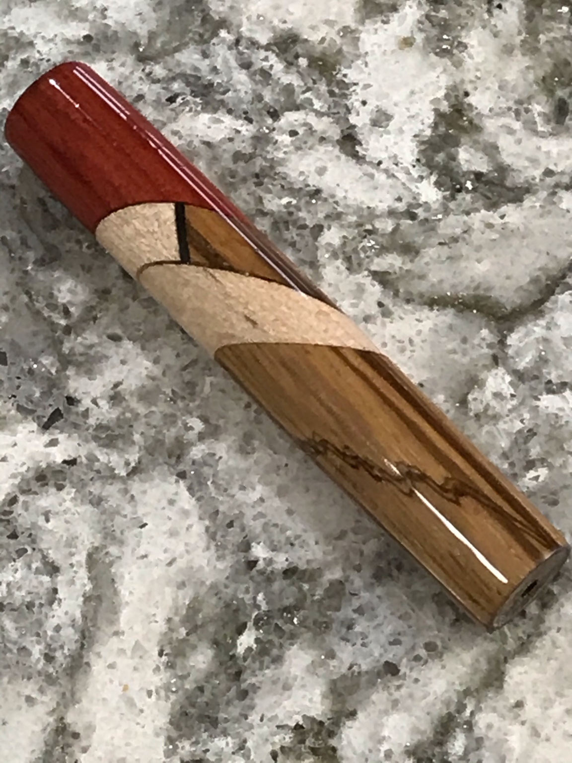

Blank is just a glue up tryout, I know it's a "POS". But what do you think of the finish? Not the best photo, just used my phone. What product do you think I finished it with?
Looks like a thin CA with a flex modifier (dimethyl sebacate), it might have other additives but this is all that is listed on the SDS. Gluboost and Mercury Flex both use dibutyl phthalate, but again both of these might have other additives also. In all my CA studies this is the first I've seen dimethyl sebacate
As viscosity goes , it's on the thick side. Because it is repositional for three minutes I thought it might be a good candidate for finishing. I did use accelerant. Also been using it to glue up wood segments. So far, I've had no failures.
I have used it successfully on some laminate repair. Never tried it for a finish. I have learned you do not need to worry about shelf life. It dries up in the bottle on me after a few months, so you definitely know when not to use it anymore. Not a bad product by any means.

Most standard thin CA is a pure chemical, ethyl-2-cyanoacrylate. When this polymerizes (cures) it forms a hard but brittle surface (something we encounter with pens, the hard being good but the brittle being bad). Adding another component to the mix can do a lot of different things, most notably slow the cure time and increase flexibility of the polymer. Typically medium and thick CA are just mixtures of ethyl-2-cyanoacrylate (thin CA) and methyl methacrylate (plexiglass) as a thickener. When you move to 'flex' the additives are a little more exotic and are supposed to react with the ethyl-2-cyanoacrylate in a specific way to yield specific properties. Kind of like how different metal alloys have different properties - think cast iron versus 316 stainless. Just like when metals get too hot, the environment can change properties of the CA polymer (usually platic gets brittle, especially in the sun). The paragraph that I highlighted suggests that some CA with 'flex' can quickly lose their 'flex' properties or have other undesired degradation (within weeks). I suspect that CA manufacturers that market their product for finishes (Mercury/Gluboost) have tested this and it's not surprising that they both use the same plasticizer. The one that Ken has here by Dap uses a different platicizer, so I wonder about it's long-term performance as a finish. It's possible that it could perform even better than others - maybe the others avoided this particular platicizer for cost/availability issues. I personally stick with plain old thin CA (ethyl-2-cyanoacrylate) because I like the devil I know better than the one that I don't. But either way, I find it all very interesting (I hope my explanation helped).
Very interesting. Thanks for educating us all. I too will stick with what I've been using. I am just going to keep this little experiment around and look at it every once in awhile to see if it yellows or cracks or whatever. In my mind though, it never hurts to try different things once in awhile. CA, I imagine was not made to be a finish until one guy somewhere started experimenting.
Thank you for the explanation, it makes sense to me now and I have a much better understanding.
