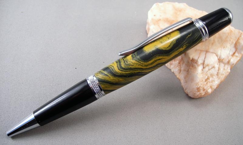

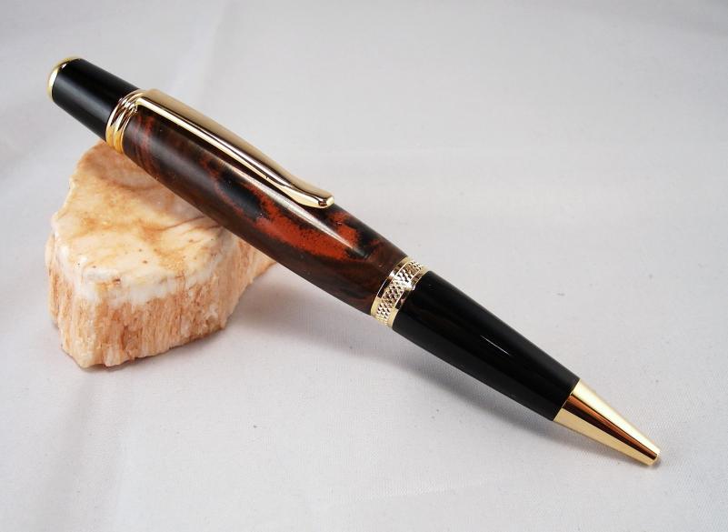

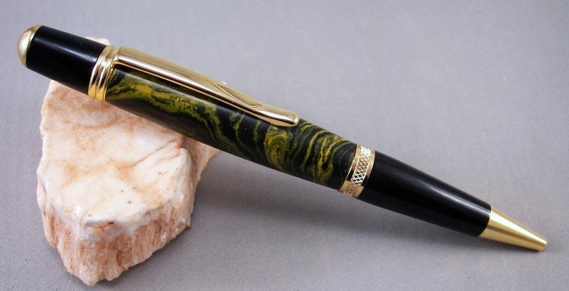

I have a repeat regular customer who loves well-marked, defined ebonite. This person is very discriminating in choosing various ebonite blanks. As to the finish, he requires that the material be allowed to display its own inherent sheen and luster. I have made 3 pens for him in this way, and I attached some pics of them. As he puts it "...ebonite is not what it is meant to be if it is covered by a glassy, glossy topcoat...". For these reasons, I finish the blank with all levels of MM, and stop. Ebonite, being a multi-laminate of rubber, does not necessarily need any top protection, and because it is rubber, most applied topcoats would not adhere well, IMHO. Anyway, you be the judge.

Ed, I agree with you. I was citing my own experience with my one customer who has distinct wants and tastes. He is an avid collector of vintage pens, and is telling me how the original ebonite and vulcanite barreled pens were done. I think I should have been more forth-coming in my original narrative, because obviously my way is certainly not the only way; it was customer requirements. My biggest problem during fabrication was heat, but as we all know, by using a sharp, fresh drill bit, frequent cooling of the bit, and finally use of sharp cutters, like the carbide insert types, the final result is a lot easier to attain.

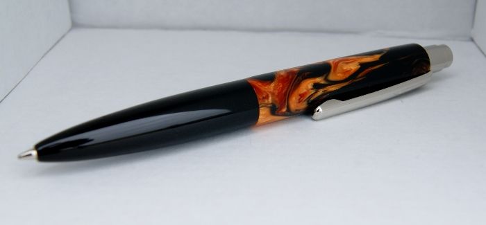

If I want it super shiny I do it just like PR. MM all the way up to 12000 and apply plastX
http://i1136.photobucket.com/albums/n496/Brooks803/DSC01968700x325.jpg
