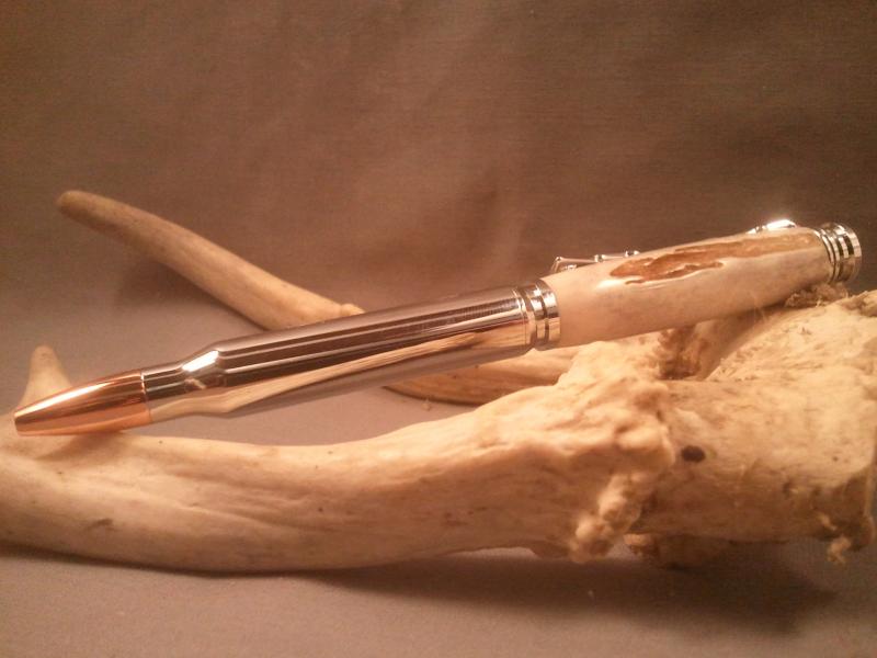

I start with 400grit (maybe) them MM to final size, then i use med CA to build it up, then wetsand thru MM again (different MM of course) or i dont put any finish on it after i MM. This one has no finish, just mm and buffed.
