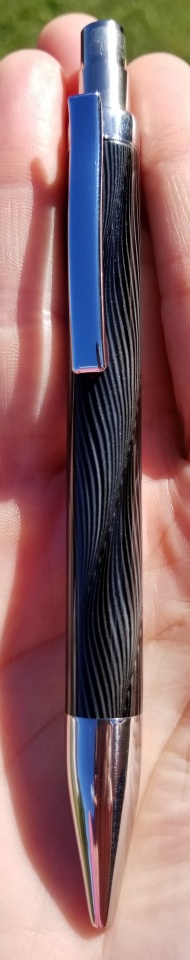

I have made a pen from Casein that I got from mrburls actually. No cracks here, but I didn't use any liquid at all during any of the process.
Very slow drilling and cooling with compressed air. You must keep the heat down at all costs. When I say slow, I mean 1/16th to 1/8th of an inch at a time with a sharp bit. then cool down.
Dry sand 400 to 800.
buff with 4 stage buffing system (library article by TonyL)
This brings a very nice shine. No CA needed.
Very hard to photograph this pen, but this one is decent.

Thank you, Lewis, for your recommendations.
That is a beautiful pen you posted, and I like the curvy patterns.
Is the Casein actually black ? . Did not know you could get it in black.

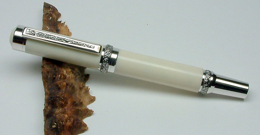

Mal I made one using a Roman Harvest. Heat whilst turning is an enemy. As an added touch I popped out the top and made a custom one with the same material.
The finish was skew on the flat then Triple EEE.
Peter.
Morning Mal, it is actually black and grey. This is vintage casein. Casein was made in a lot of patterns and colors it seems. Nice to work with except for my mention of heat. It's only been a couple months since I have gotten it done, but so far, so good.
