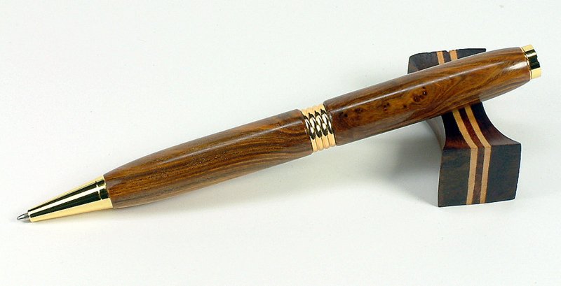

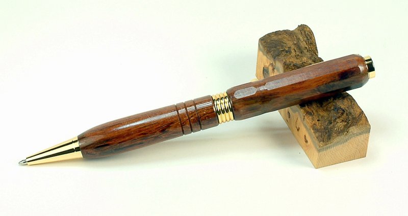

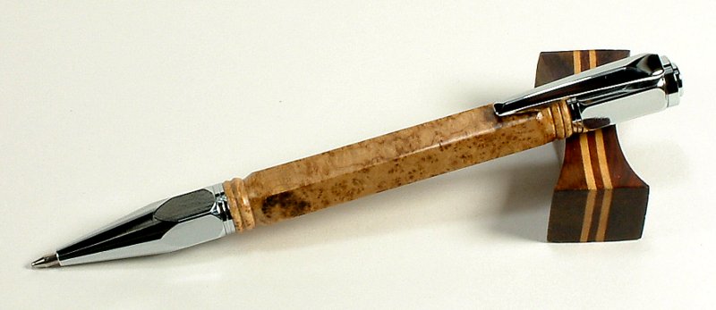

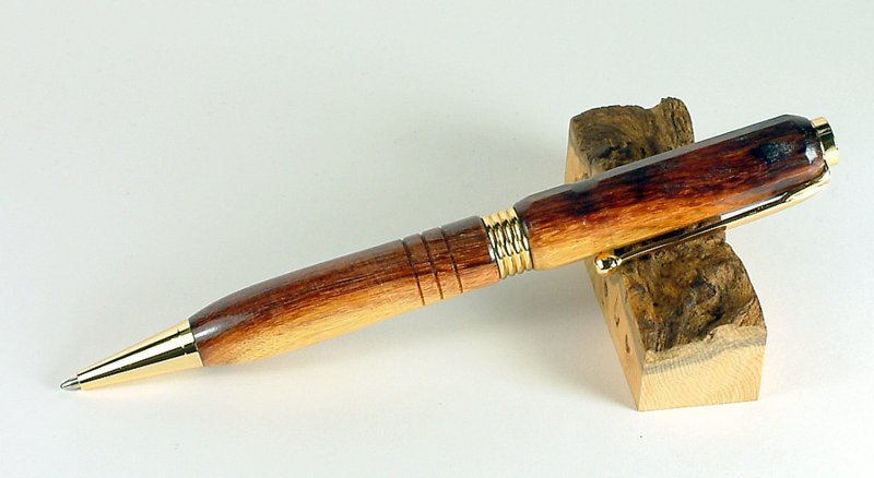

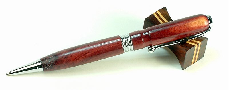

and if you want a really high shine, just buff the CA.... or apply the EEE (1st) and shellwax cream (2nd) with buffing wheels this is how I do all of my small turned boxes.

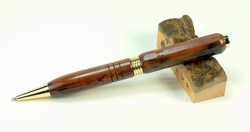

I have worked with most all Aussie Burls and studiously avoid the voided ones and would never entertain the thought of stabilising. I am a great fan of tripple EEE I only give one coat of CA.
You mention you prefer this and that I find for other people without prompting or saying they really like my finish.
I do not think your crazy but having your cake and someone else eating it two different things IMHO.
You have not enclosed a pic of your pen if I may be bold please find a typical Aussie Burl pen finished my way to illustrate what I have said.
Kind regards Peter. Random pics.

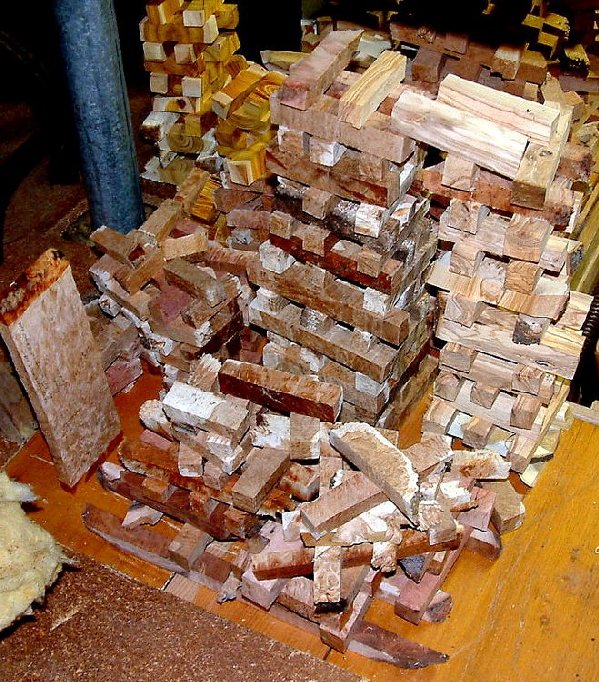

Timber pens, and especially burls will always be prone to problems. To minimise the chances of problems arising after the pen is finished and gone to a new home, I have added a few extra steps to my process.
I make sure my blanks are good and dry, if you are not sure don't use it yet.
I drill my blanks, then run thin CA into inside of the hole making sure it gets full coverage, let it sit for 24 hours to cure.
I only use good 2 part epoxy to glue in the tubes, making sure to get full coverage on the blank and tube, no air gaps.
When doing a CA finish on burls and timber with voids than need to be filled, you need to let the CA fully cure before sanding, because the CA will shrink as it cures and leave an uneven surface. I try to leave mine for at least a week before sanding and buffing. On high end pens, I will even let it sit longer before sanding, and then once I sand it down to size, I let it sit for another couple of days, then sand again with the finest grit, then buff.
I know many people think this is over the top, and want to finish their pens in one day, but I have found that since I stopped treating CA as an instant finish, my quality has improved out of sight. I know I have done all I can to make sure the pens stays looking good. As long as the customer looks after the pen it should look good for a long time.
There will always be the ones that leave the pen in the car on a hot day, or leave the pen in a shirt pocket and put in in the washing machine, these things don't deserve warranty , but I have repaired such things for good customers.

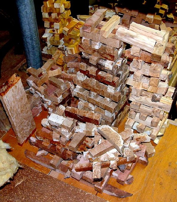

Another tip I found best way I belt my blanks up into the roof space for quite a while with a fan blowing 24/7 especially with burl this was a few one time theres Olive, Mulberry seven types of Burl Mallees etc.
One stack is my test one I weigh it weekly and when it weighs the same for two weeks I give them another few weeks never had a failure. SWMBO gave me a tip also hold the blanks on the inside of the arm blanks not ready feel cold compared with dry blanks that works for me. I put a loft ladder up in the ceiling in the hall can access the roof in a minute laid yellow tongue and timber up on the rafters for easy access and use
In the last couple of years put a simple fan that pulls the air from under the tile ridge where we live we get down to minus 8 C but a real lot of sun in the winter and the house central heating gets a boost with 8 outlets from the ceiling.
Using Solat Cells my last electricity bill was a minus 200 bucks gotta be happy with that.
Peter.
