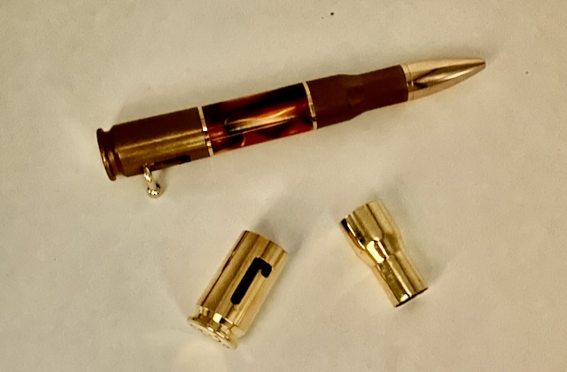

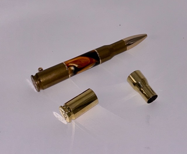

I just hi shined a casing with tripoli and Simi paste. I used a small lathe with a 4" rag wheel (buffing wheel). Came out real nice however my hands got polished also. No finish going over it. The shine is the finish.
These look better close up. It's easier to polish than get a good photograph. Easiest way to buff is with a 3 or 4" buffing wheel. Any metal polish should work out well... Flitz, Simichrome, etc. I might experiment and wet sand with fine dental pumice first.
Nice looking. I haven't thought of doing bullet pens, but these show the beauty that's possible.
