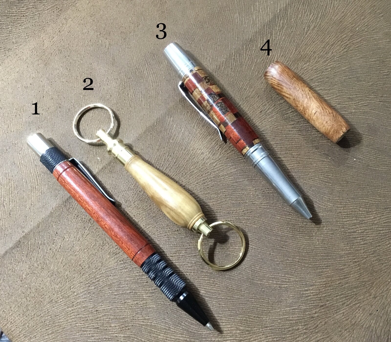

Hello I'm a beginner only i can tell is about my short experience,I hope the pictures can help.
Number 1 in the picture
Wet Sanding 400 to 600 with abranet sand paper and doctor woodshop walnut oil.
Then EEE friction polish and finally pens plus.
Satin Finish natural to the touch after 4 months.
Number 2 in the picture
Finishing: micro mesh until 12,000 and then Friction polish pens plus, it has a natural touch and after 3 months it looks shiny.
Number 3 in the picture
Finishing :CA glue regular process with BOB SMITH odorless.
2 coats of thin CA then 3 coats of medium CA and a little touch of sanding with micro mesh just with the more abrasive 1,500 and 2400, then another 3 more coats and after that all the micro mesh process.
It's shiny soft to the touch but it doesn't have the warm of the wood.
Number 4 in the picture
Finishing:unexpected CA finishing
I started with my regular process all micro mesh and CA glue.
But I realized that there was a scratch in my pen blank,
so I started sanding down with micro mesh until the scratch went away and in the process I realized that it was loosing its glossy finish and getting a satin finish and very soft and creamy at the touch.
Anything you want to talk you can write me I speak Spanish 😁
