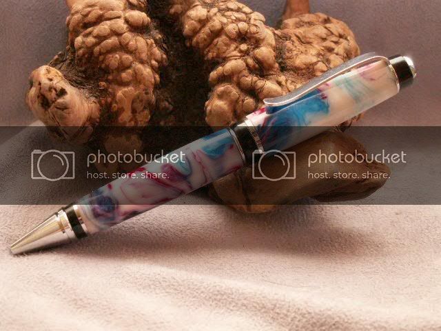

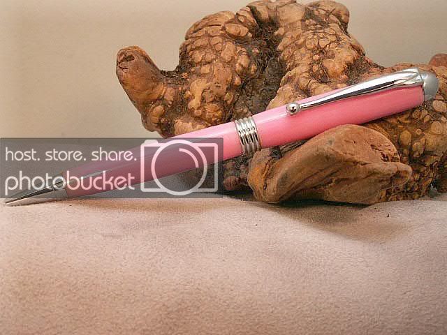

Finished a couple in Acrylester today
See more from Pipes
Status
Not open for further replies.
Pipes
Mar 17, 2006
967
4511 2nd street Ecorse Michigan 48229
This stuff IMO is a PITA to work with . BUT worth it for the colors out there .. I love the colors in these two...The pink with this kit has a IMO retro look ..
Anyway with sharp tools and mean really sharp and very SLOW drilling you can work this stuff . BUT I would NOT recomend it for a new turner at all because of the chipping when turned and it a crack when drilled easier than anything I ever turned and I have turned MOST plastics out there ..
But again IMO the colors make it worth while ..

Sweet looking pens!! Is the top one the Patriotic Swirl? And which kit did you use with the pink one?

<br />Sweet looking pens!! Is the top one the Patriotic Swirl? And which kit did you use with the pink one?
I drill everything on the DP's slowest speed. Water, yep! A few drops of dish washing liquid to help the water do it's job a little better. I learned a little trick from Ed4copies and do not drill completely through each blank and then cutting it off afterwards. I would periodically have the bit catch the blank on exit and bust it apart. I don't really find it a pain, just that it has it's peculiarities as does other acrylics and woods.
The pink kit is a Berea 7mm round top bought from AZ not many do this kit I love it personaly . and it sells well for me .And yes the other blank is Patriotic Swirl.
