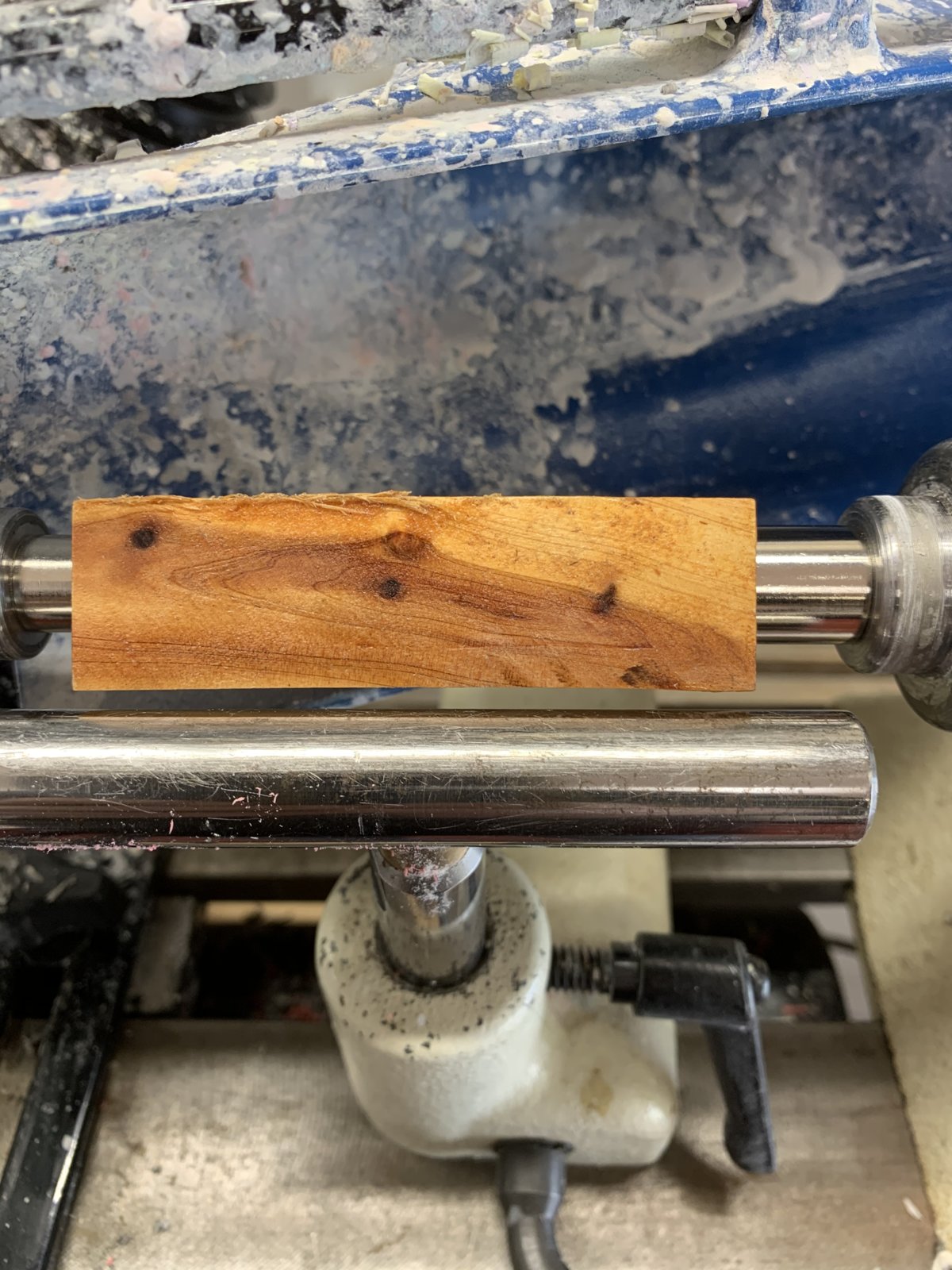

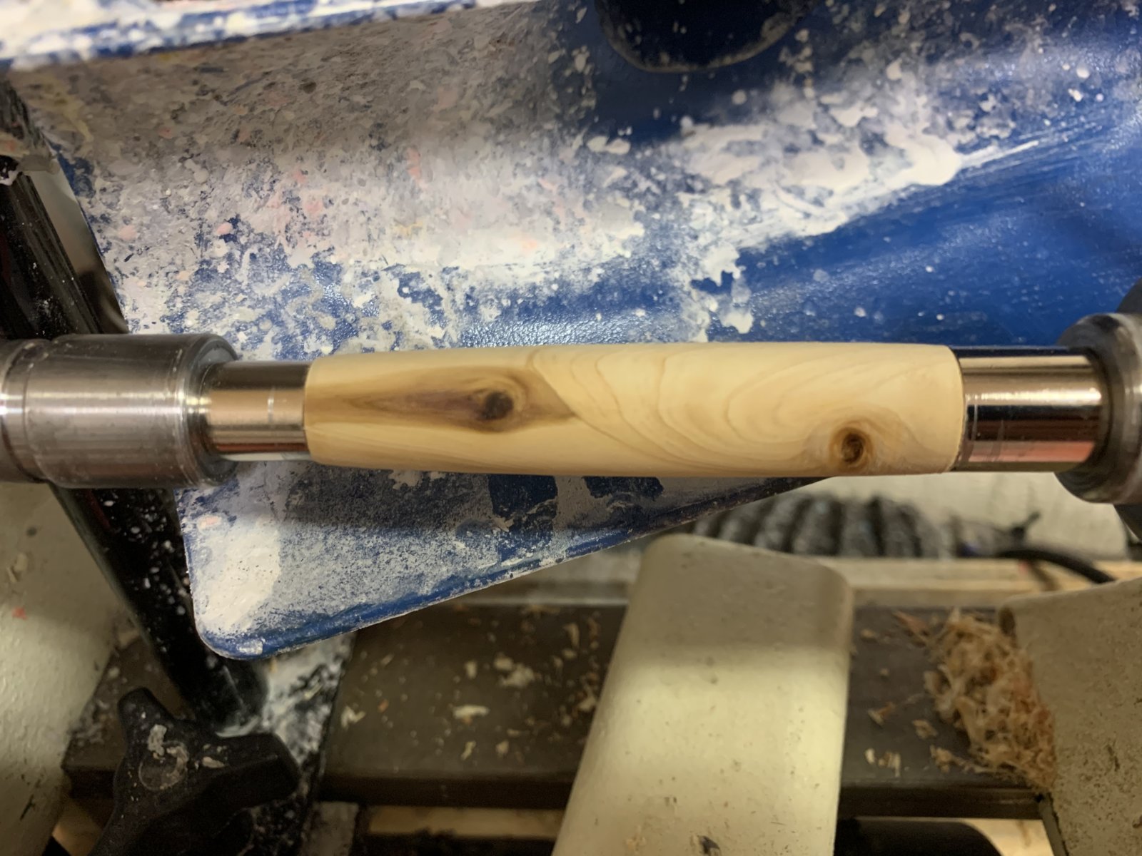

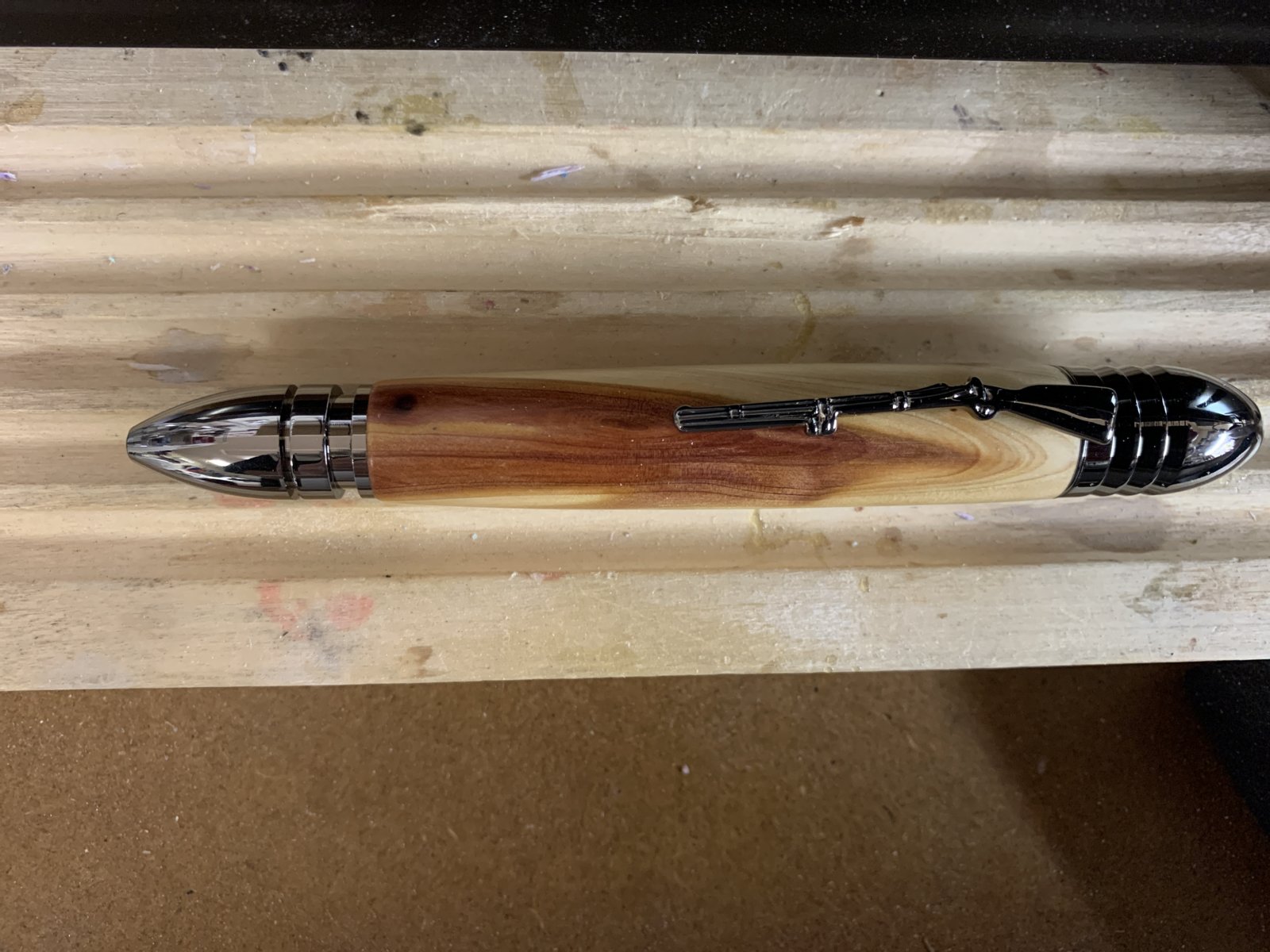

This is an interesting blank to be with a Civil War pen. Do not want a high gloss CA finish. I have Tru-oil, Danish oil, can use a few light coats of thin CA. Can sand with coarse paper and have a rugged worn look before oiling. Comments please. If I do not use what you suggest do not be offended. Thanks. Frank
