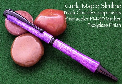

While I've used Prismacolor on a number of my pens, they've never ended up with a solid color. It's always a dyed granite looking effect. Here's an example:
I think any moisture (water or solvent) is going to smear Prismacolor. With the pens I can make it work for my benefit. If I needed something solid I'd start thinking about pressure dyeing the blank.
