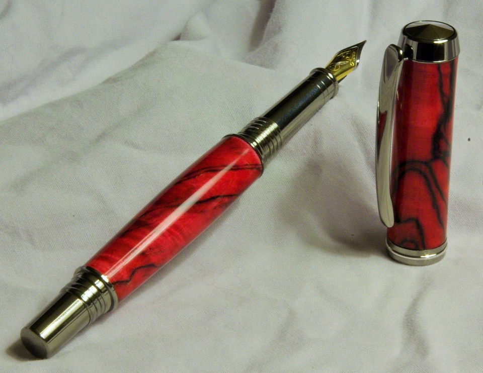

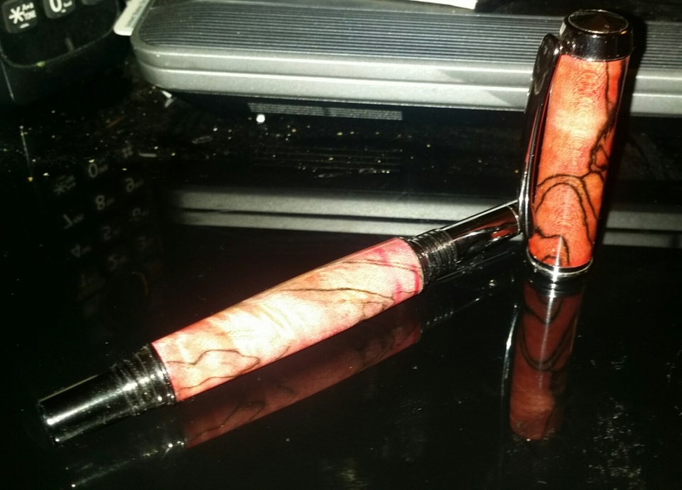

I had good luck using Alumilite dye as a wipe on under CA.
You can get some off with WTF to tone it down but the WTF will not stay.
Top coat with CA and finish as normal.
Downside.. over a year or so that bright red has gone a bit pink but my blue pen has held it's color. Maybe the red dye is just soaking in more or I went heavier with the blue.. Anyway.. go dark..

If you get the dye from Hobby lobby using a 40% off coupon it's not that expensive.. a tiny bit goes a long way.
I was thinking and another reason this pen is fading may be the hackberry.. Not a super dense wood. the others I did were buckeye burls.

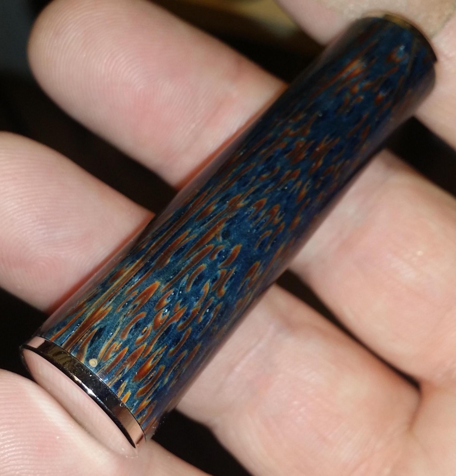

Sorry for the bad picture.
One I did last night..
Red palm blank, Alumilite blue dye wiped on till it was almost solid blue/black then WTF applied 6 times to remove dye until the desired color depth is achieved. Yes WTF will remove the dye..
Finished with CA.. no sealing was needed.
I check with another person who had a red buckeye pen I did in 2014.. No fading. It must be something about the spalted hackberry that caused the fading in my other red pen.
