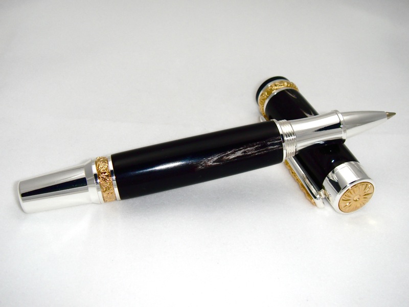

When I made my Indian Water Buffalo horn pens I applied layers of thin CA until it stopped soaking it in then moved on to medium CA.
