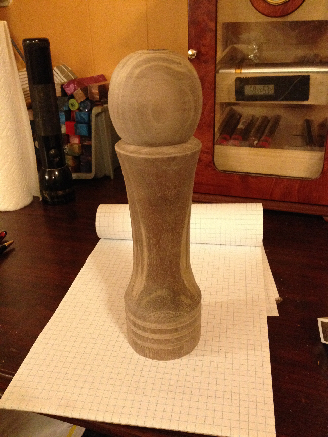

Not sure if this is the right forum for this question, but I have a pepper mill to give as an Xmas present that I made and have yet to put on a finish. The blank was a piece of Black Walnut. I'd like a glossy finish on it but I'm not familiar enough with finishing products to know if I'm going to use the right stuff or not. I was thinking a CA finish, but that seems like an awful lot of CA for a 9" pepper mill. Any suggestions on products? Thanks.
Bobostro61
Jan 5, 2013
576
Chicago, IL
Actually it's 10". Here's what it looks like right now.

You probably want something that will be hardy enough to withstand frequent handling.
My suggestion would be to apply a coat of sanding sealer, and after it dries, denib it with the highest grade of sandpaper you used in finishing the wood. I suggest that because black walnut tends to have an open grain that will leave gaps on the surface if not treated with a sanding sealer.
After the sanding sealer treatment, apply multiple coats of WOP, denibbing lightly between coats.
This is in fact a good suggestion, the sanding sealer will do wonders on that wood and the preparation for the top coating that can be one of many gloss varnish's available where you are.
If you were in Australia, I would be suggesting the use of Floorseal Oil made by Feast Watson. They recently changed the names of some of their products this one was called Floorseal (only). This is one of my best finishes and durability, easy application and shine, a floor finish that is as liquid as water that is easy to spray on and leave...! This is a Tung Oil based stuff..!
It's no easy to made recommendations when we are in different countries, we all have different products and products names to deal with but, the "basics" do apply all the same...!

I'm in the process of finishing some Black Walnut RingMaster bowls...
I used a coat of sanding sealer...Minwax.
And I am currently on the second coat of Polycrylic...Minwax. I figure at least another three coats with sanding between to get a thick, glossy coat on the bowls.
Why polycrylic? Easy, I had plenty of it already.

I encourage you to consider walnut oil or Watco Danish Oil (natural color) before a film finish. You'll enhance the grain and darken the walnut. Make sure the oil had dried before applying the film finish.

Awesome. Thanks for all the great tips. Sanding sealer with the WOP seems to be the best way to go to me. I'll post a pic when its all finished.

You've already finished the mill so I'm late to the party, but you can use the same polyurethane as a sealer... I use the full strength poly, sand lightly between coats and then top with the wipe on.... the sanding sealer won't hurt and will do equally as well as the poly.

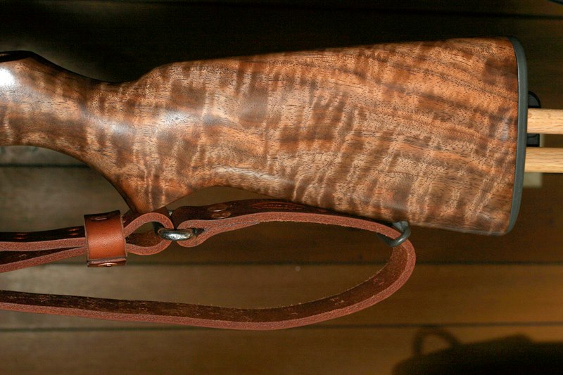

Lets see here, Walnut has a very unique look with oil and CA will never come close to matching that look.

Unlike CA, oil is kitchen safe, food safe and all that, will never wear off, crack, blister, cloud etc..
