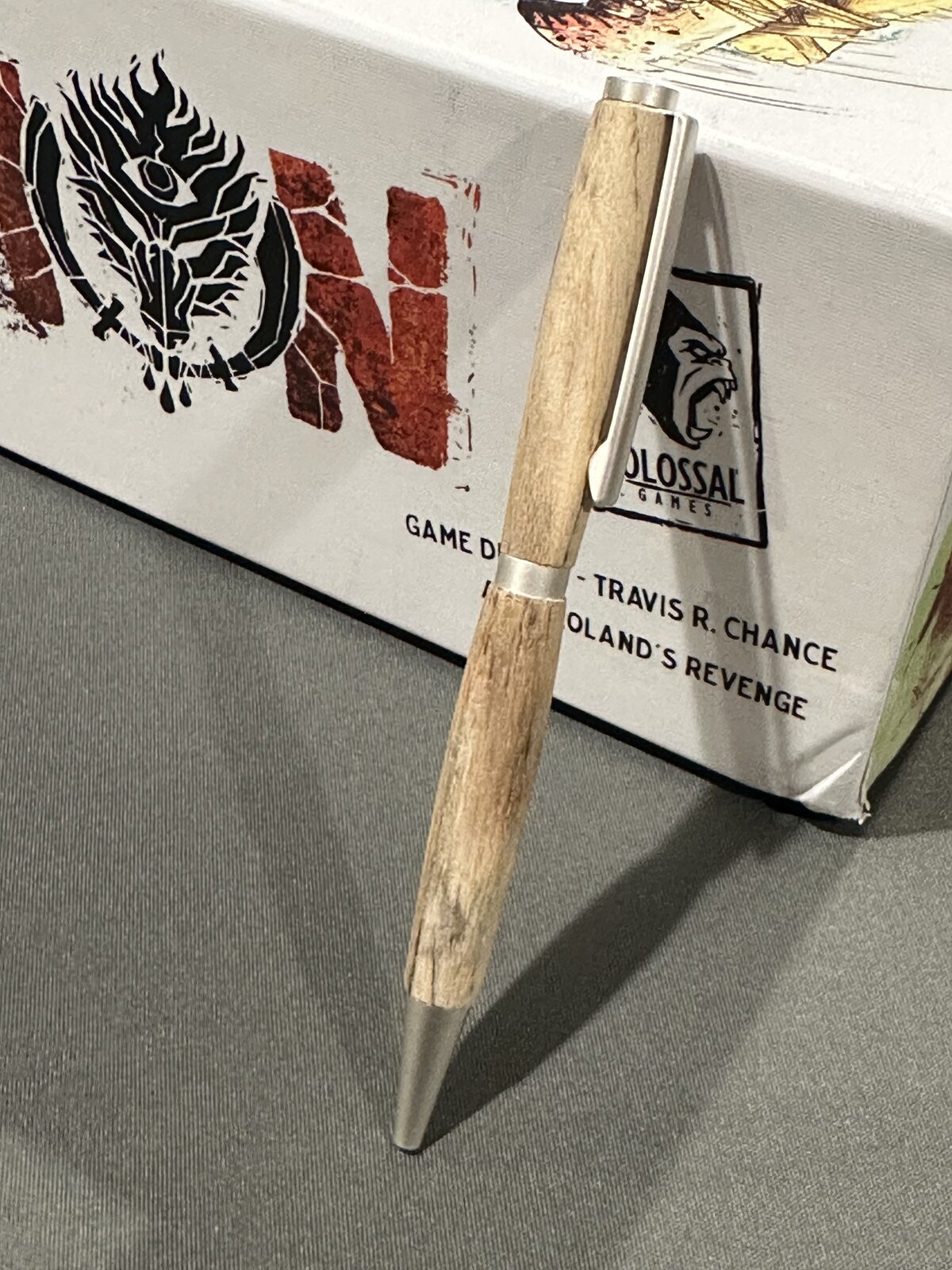

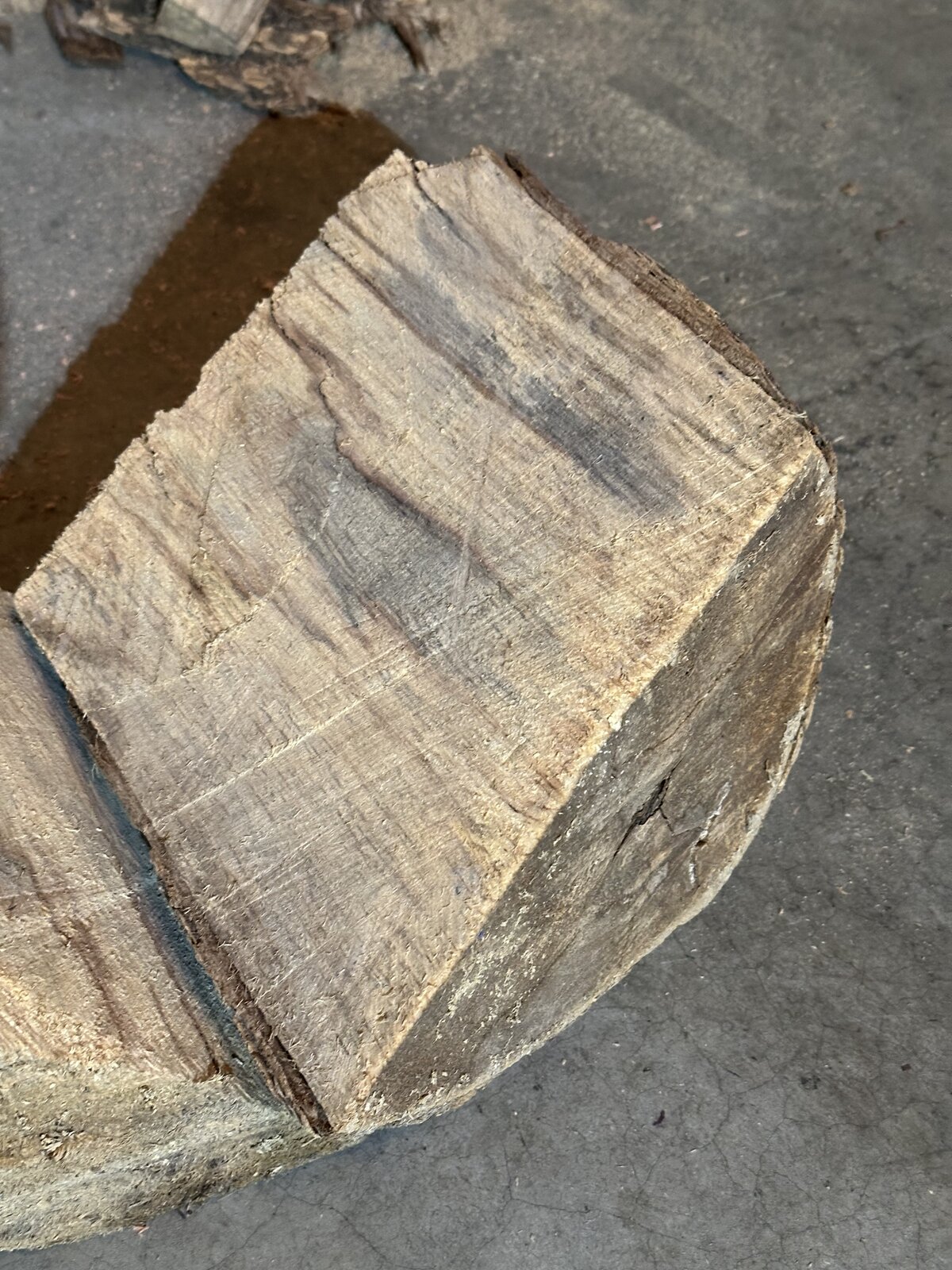

I have some very lightweight wood I scavenged on a vacation years back. I'm finally making some pens out of it as a memento, but I'm very new to turning.

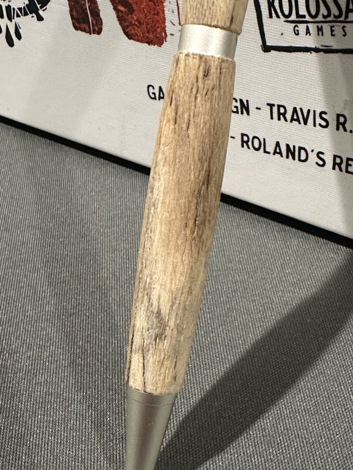

I cut up a few blanks and turned one of them as a proof of concept, since I wasn't sure if this soft dry wood wouldn't just fall apart. With light cuts and lots (lots!) of sanding I managed to get a smooth surface and it feels okay. The wood almost feels like a balsa wood, or at least that level of density. I didn't fully turn it down since it was splintering a bit at the ends already, and this was just a test run.
I don't think this will hold up to much handling before it starts to splinter a bit and dent, and I'm thinking about simple ways to add some resilience. Would simply adding a few layers of thin CA be a good idea before final sanding? I could do a full CA finish too, but wonder if it will just crack due to the softer wood.
Any thoughts or ideas are appreciated!

If you cannot stabilize it yourself or have somebody else do it, then I would suggest turning (or sanding it down) a little smaller than the finish size and build up a good layer of CA glue as a finish.

I would give it as much CA as it will take . It will harden the surface for sure and hopefully somewhat deeper , at least in the softest areas . I think you will get a lot of fumes , so take care . For that situation , my preferred applicator would be a strip of craft foam , about an inch wide , with about an 1/8 inch bead of CA across the width , applied to the under side of the blank , rotating at about 500 rpm . Others have different techniques , which work for them , but wouldn`t for me . That wood is a good candidate for stabilization .

The Gluboost ultra thin (green label) will soak into this wood to help stabilize it. Then you could do a regular CA finish on top with Gluboost medium and thin.

Great thanks everyone for the tips! I'll check out the ultra thin. I didn't know about resin stabilization before, but maybe I'll look into that too, although it sounds like it can be hit or miss depending on wood type and I have no idea what this species is.

It looks like the green label has a lacquer in it, and red label doesn't.. is the green lacquer ("fill and finish") the recommended one to try?
