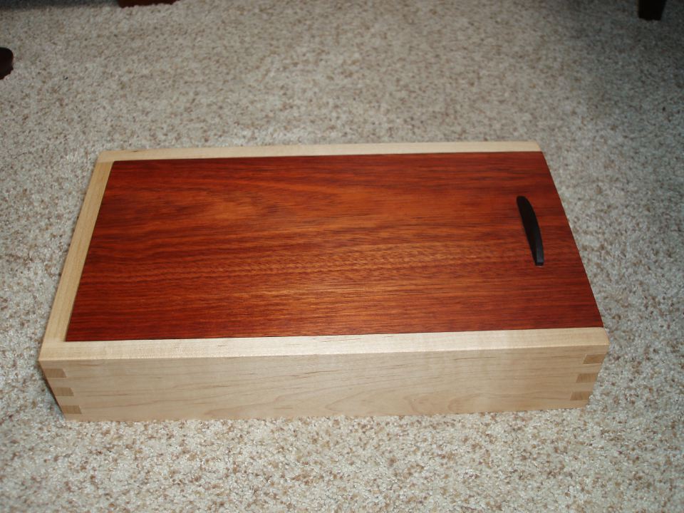

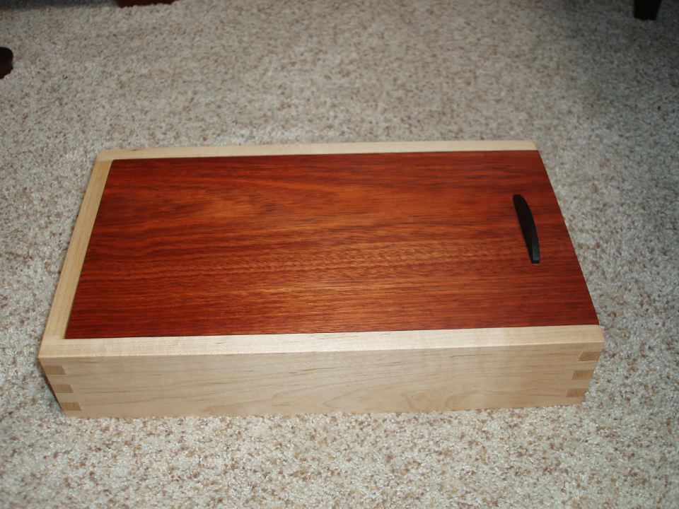

I looked at the safety data sheet (SDS) for the MINWAX Tung Oil Finish and it includes more than just mineral spirits, linseed oil and varnish. It includes MEKO as well as other chemicals I did not recognize.
If you are looking for a food safe varnish oil finish, consider Tried and True Varnish Oil.
https://www.triedandtruewoodfinish.com/products/varnish-oil/
I used it on this maple and bloodwood box, which was made to hold food ingredients. The photo doesn't do justice to the finish, but it is a delight to the eyes and the touch.
P.S. Nobody has mentioned it here yet, but PLEASE be sure you properly dispose of the rags and applicators after applying an oil finish, whether MINWAX or any other brand. If you don't, they can reach very high temperatures and catch fire, burning down your shop. I heard rumors that oil finish on rags was the cause of last year's devastating fire at Notre Dame cathedral in Paris. Even if it isn't true, it is still a very realistic scenario. PLEASE be careful and know how to dispose of your materials. Putting them in a jar of water is one good solution.
