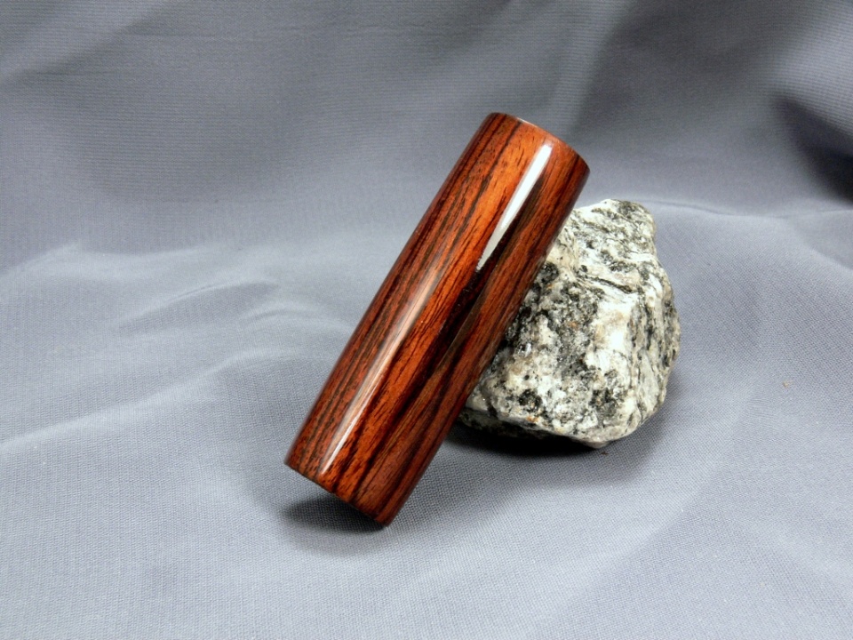

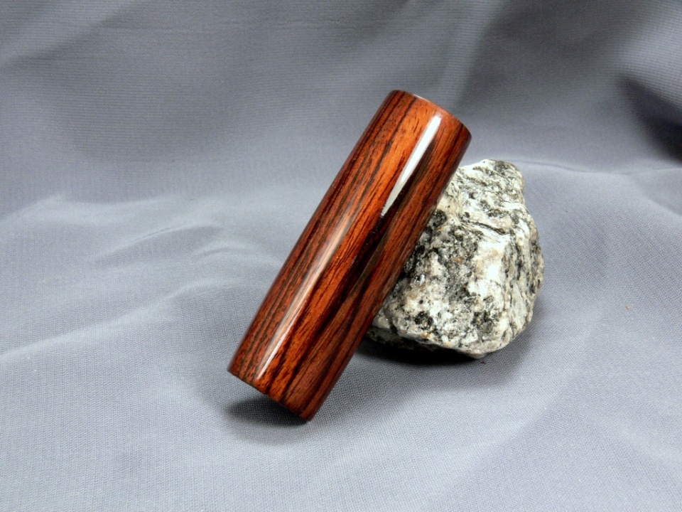

Took a picture of one of the test blanks I made using this method. It's not perfect, but not bad either.

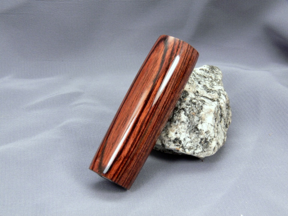

This is another test blank I made. The only difference is the first one I used the polishing creams from the Stick Fast system and this one I used white diamond on a beal buff.
When sitting side by side the first test blank is just a tad shinier. However the second one is absolutely glass smooth. I think I prefer the beal buff, but either way there isn't much difference.

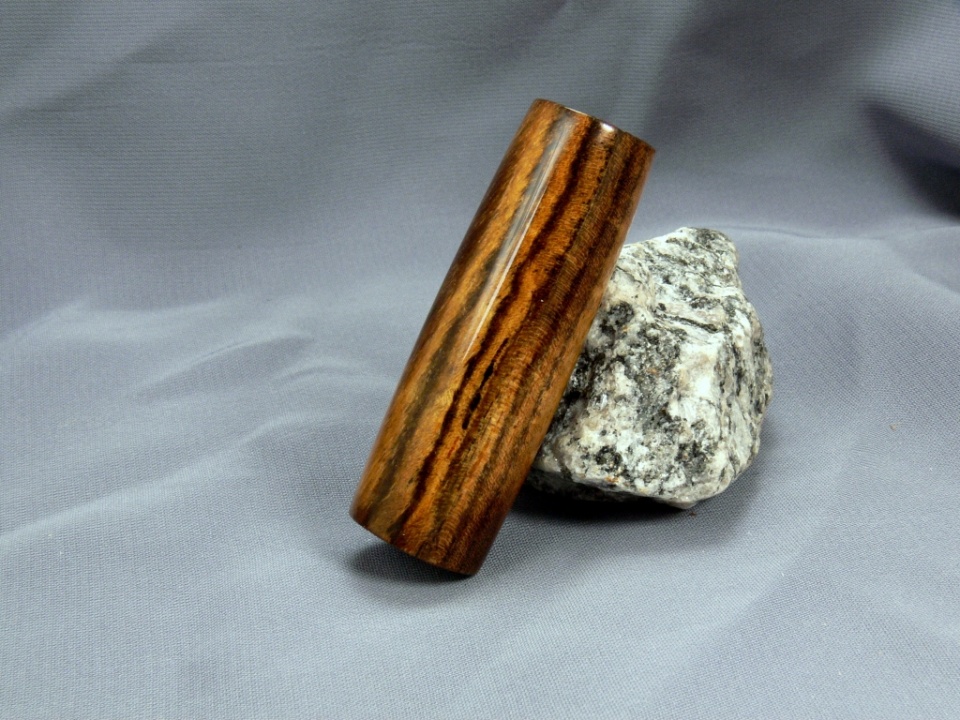

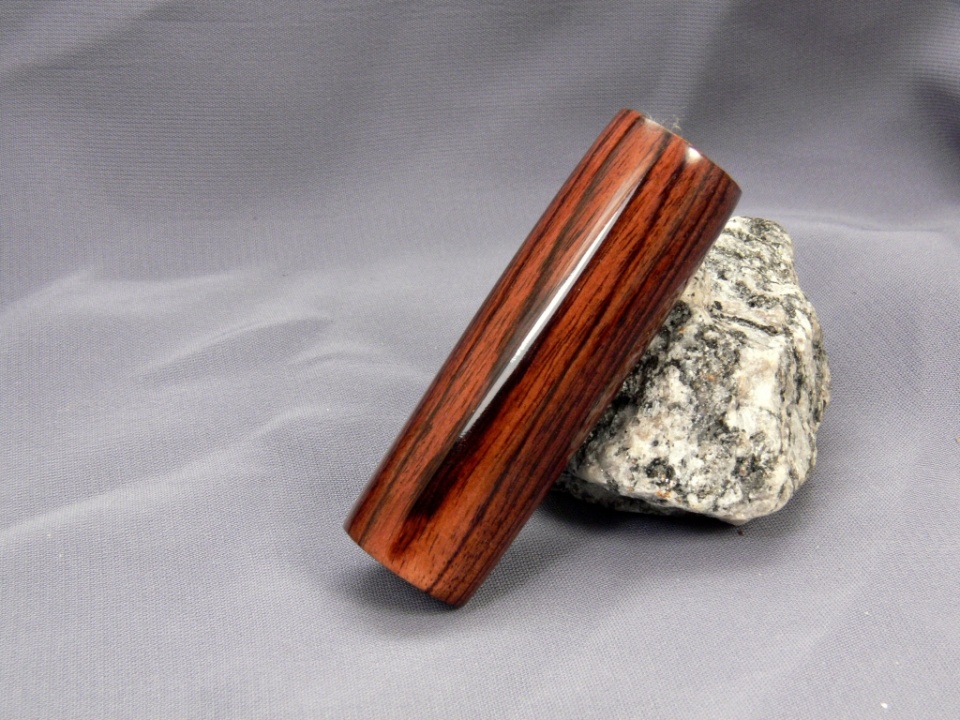

This morning I redid the test blank twice. The only thing I changed is I added 1000 grit to my sanding to try and remove most of the microscopic circular marks. The picture one is polished with the Stick Fast polishes. Picture two is straight to the buffer after sanding and polished with white diamond.
I think this finish is about as good as I can do. I've seen others post pictures of their finished pens that look way better than these test blanks. I think I just have to accept the fact that I'm not going to reach that skill level, at least not now.
If anyone else trys this method and comes up with some better ideas please let me know. Any suggestions for improvement would be appreciated. At least for now this will be my finishing method. It's dead simple, consistently repeatable, and gives pretty decent results.
