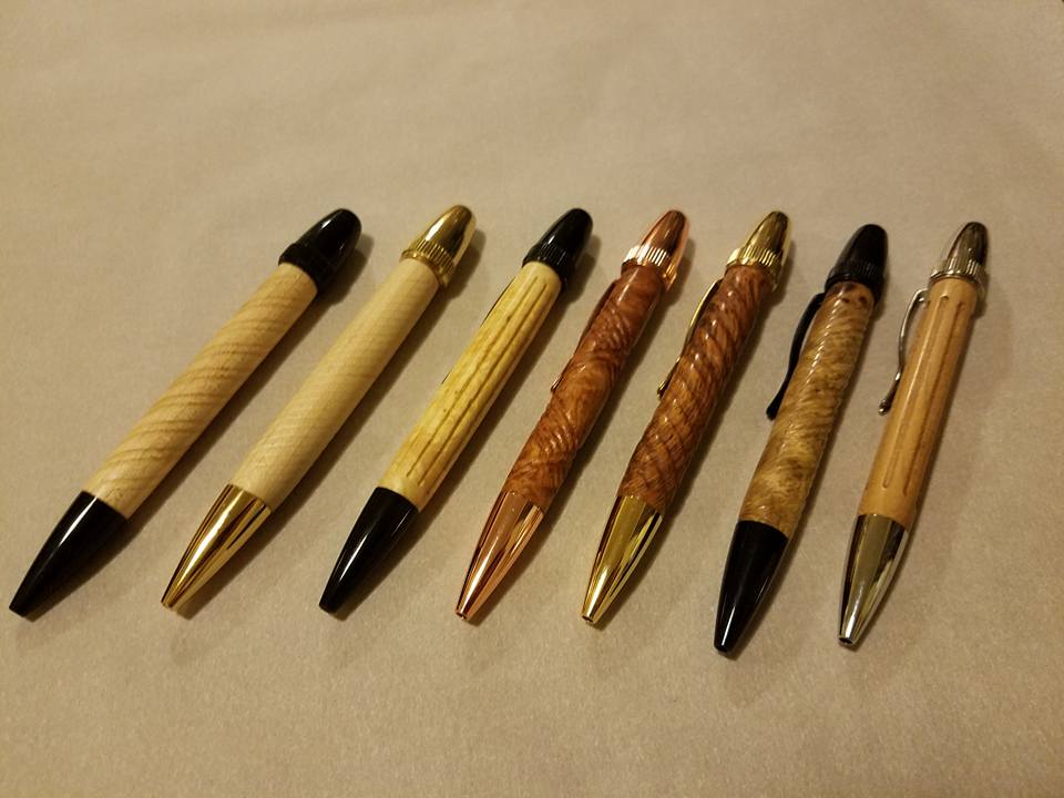

I finished all of my Christmas pens a week early, so I decided to try my hand at figuring out the Beall Pen Wizard that has been sitting on my shelf for a year. Here are my initial results.

I like several of those.
Having never used a pen wizard, do you turn the pen to diameter and then add the details, or can you do both on the pen wizard machine?
I turn the pens to 1/16 of an inch of the bushings on the lathe, then move to the Pen Wizard for the surface carving, then back to the lathe to taper to the bushings.
