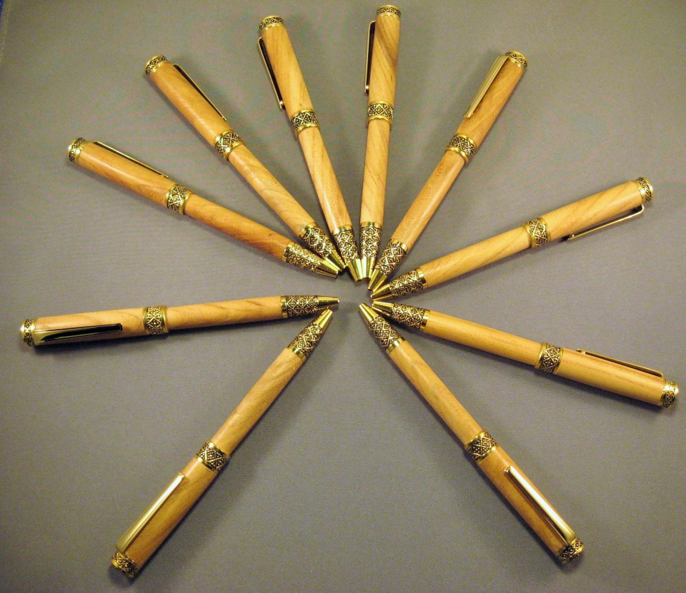

Here are the first 10 pens made in the new shed. Since February :redface:
These are Elm blanks supplied and, made for my cousin who, got me started in this hobby. He likes the Sculptured kits from PSI but, he doesn't have to turn them. I personally don't care for them at all. He also likes the friction polish effect. I don't! Thanks for looking. Now, it's onward to turning things that, I LIKE! :biggrin:

Wow! An equal opportunity shop (shed). :eek:
This shed will even produce pens it does not like, using finish for which it has distain! Just getting "warmed up" I guess.:roll eyes:
Nice job, BTW...Question: how did you turn these pens while holding your nose?:tongue:
Congrats on getting the shop up and rolling Chuck!
I agree on both accounts. Not a fan of friction polish or the kit, but still a nice group of pens!
Well now......Looking really nice there Chuck.
10 of them is a great start for the new "cave".....lol
As bad as you dislike the kit.......It looks nice with what you done.
Oh and nice pens.

They have a "Perfect Fit" look to them. Would you mind telling the drill sizes?
Thank you Mack! They are near perfect but, the Elm is a bit tricky (sometimes) the density can change within fractions of an inch. At least the blanks I have can. The drill size is 8mm.

You did a great job on the pens. Fantastic fit and nice finish. I agree about the kit and frictron finish. But to each their own even if it's wrong.
Nice pens. I Wouldn't be crazy over those kits either but if that's what your friend wants, they turn just like any other pen barrels. Personally I like the more natural wood look of the friction polishes. Also I tend to think it ain't as messy as CA, that is not from personal observation though just from the videos.
Thank you! I don't mind the appearance of friction polish. It's the cooking of my fingers I don't like. :frown::biggrin:
Thank you Smitty. With these kits, you have to mark a line at 1-13/16ths" on the upper barrel and, part off the remainder down to the brass to make room for the center band. I use a hacksaw blade that, I ground to a point. You have to approach this Elm carefully and, slowly so not to tear out a strand of wood that should be flush with the CB. DAMHIKT :redface::rolleyes:
