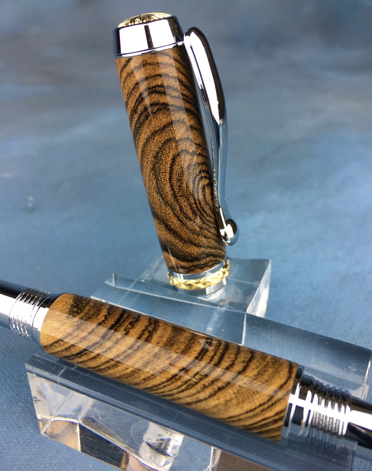

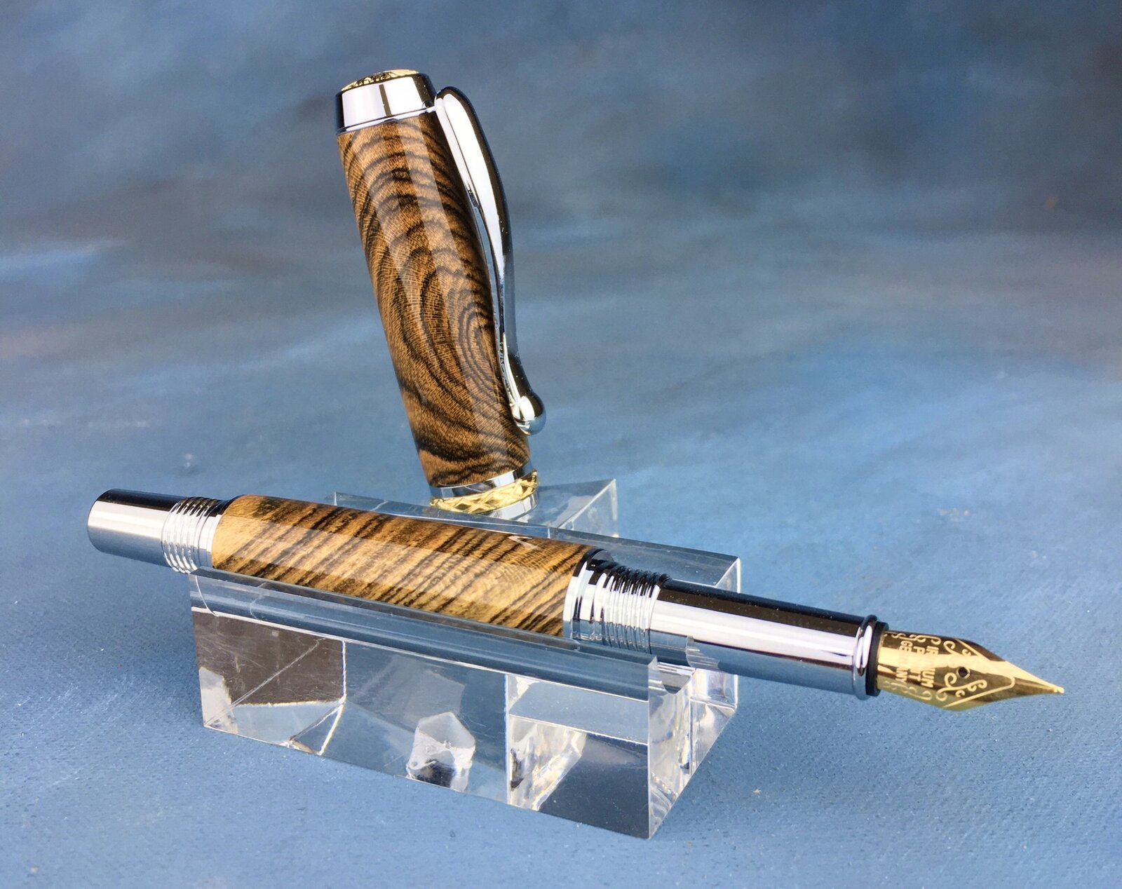

I've used this wood a lot yet somehow it never showed up on my higher end pens. That has been corrected.
Data:
Drilled in lathe with Colt bits
Glued with two part epoxy
Flushed with Rick Herrell's lathe sanding jig 80 grit
TBC turning (Brian Nikitas)
4 coats thin and 12 coats 50 cps EZ Bond CA (very light StickFast accelerator after the last thin and after each 50 cps coat
Two hour cure
True up ends again 320 grit
Thin CA on ends
Sand twice with 400 grit
Buff with wheels 1&2 on Beale buff.
Press on lathe
