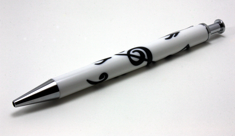

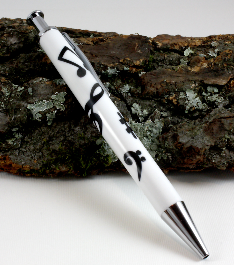

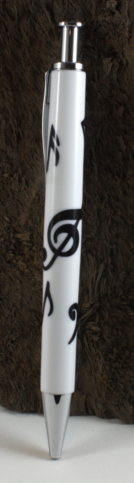

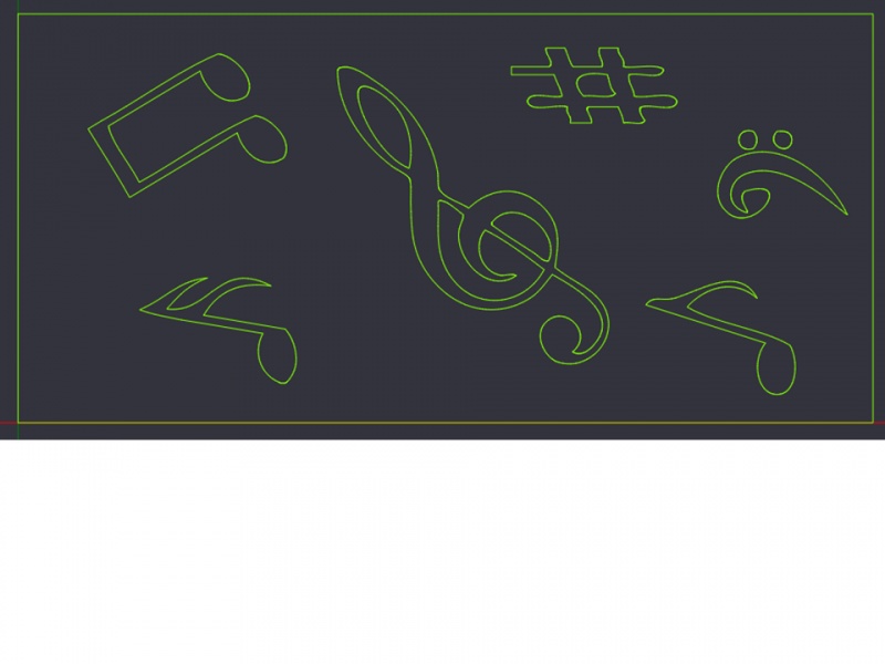

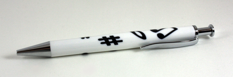

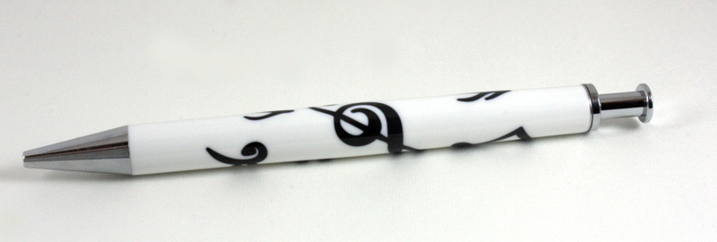

CNC pen designed and programmed on my machine:
Musical symbols on a Chrome Long Click:
CNCmusic-longclickpen2-960L.jpgCNCmusic-longclickpen3-800.jpgCNCmusic-longclickpen4-800.jpgCNCmusic-longclickpen5-800.jpgCNCmusic-longclickpen-800.jpg
This is what the flat image looked like:

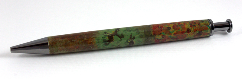

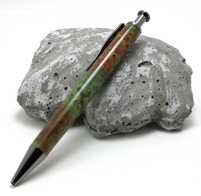

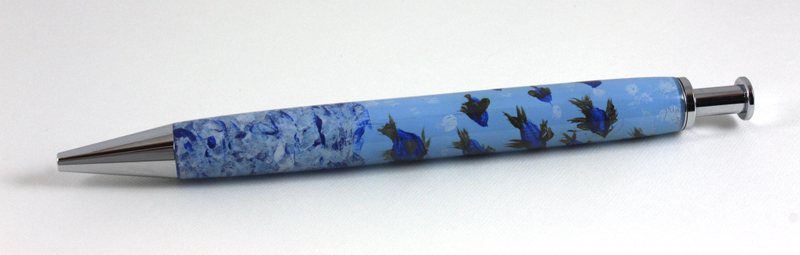

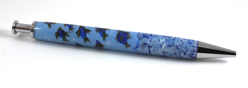

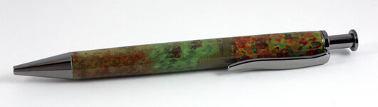

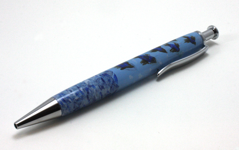

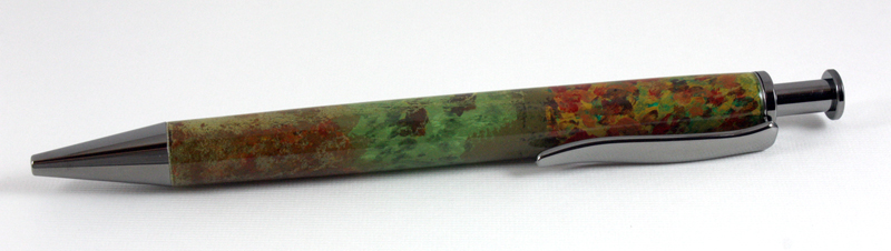

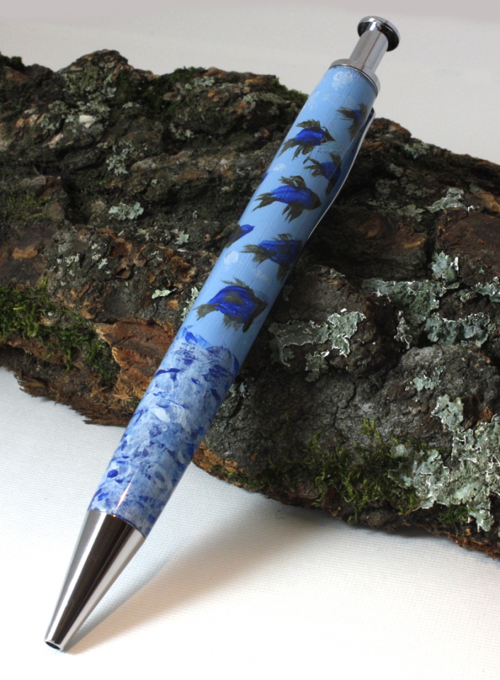

Deer Painted pen done by Tina on a Black Titanium Long Click:

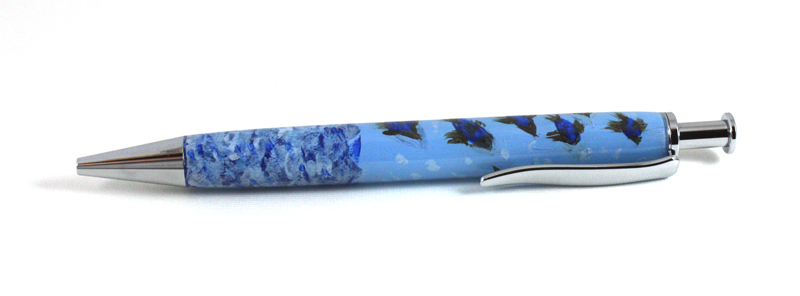

Fish Painted pen done by Tina on a Chrome Long Click:
fish-paintedpen2-800.jpgfish-paintedpen3-800.jpgfish-paintedpen4-800.jpgfish-paintedpen5-800.jpgfish-paintedpen-800.jpg

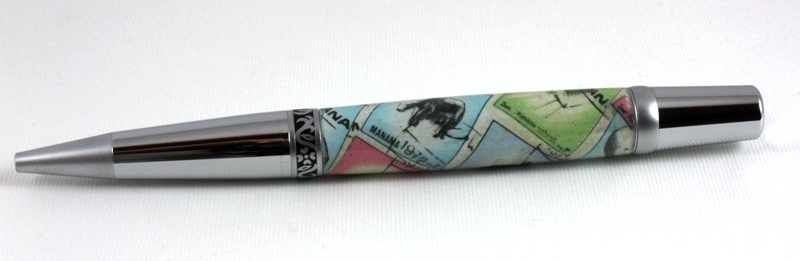

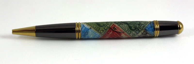

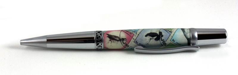

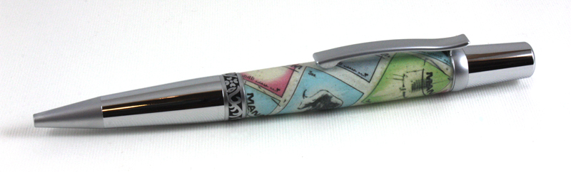

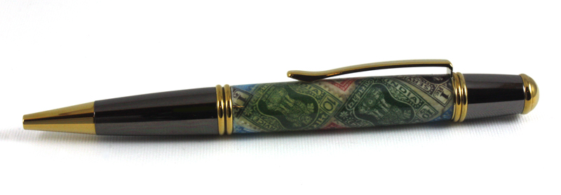

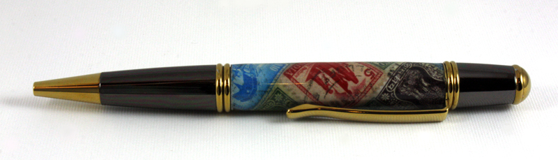

Stamp pens:
IndianStamp-ballpointpen3-800.jpgIndianStamp-ballpointpen-800.jpgIndianStamp-ballpointpen2-800.jpg
ManamaStamp-ballpointpen2-800.jpgManamaStamp-ballpointpen3-800.jpgManamaStamp-ballpointpen-800.jpg

The music symbols do they go all the way through?
By all the way through, not sure what you mean.....
The symbols were CNC'd into a 3/4" blank and then recast in black. The blank was then drilled for the pen tube. The symbols were visible on the inside of the hole after the blank was drilled for the tube.
They are not mirrored all the way through from one side to the other if that is what your question was.....
Nice Fred, very nice!
Had the music symbols gone through, they would show reversed on the other side.
