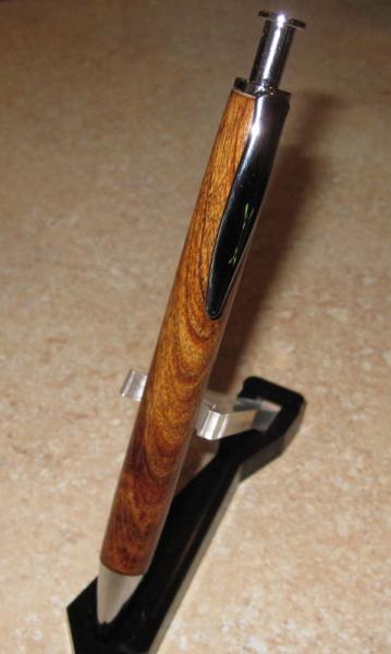

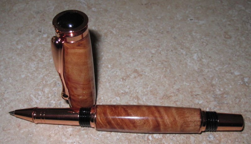

Here is a clicker using Tambooti and a piece of Australian Rose Myrtle on copper Jr. Gent.
I find the long pens are hardest as keeping the coats of CA even along such a long piece is very tricky. Starting with a coat of BLO and using accelerator between coats has helped. Takes a lot of CA though, I thought one bottle would last me and I'm maybe getting 5 or 6 pens out a 20z bottle!

Looking good Stephen. I started doing the CA finish maybe 6 years ago and find that I still am evolving the process. I truly is a learning curve and takes time to perfect. Just today I had to remove the finish twice and re-apply to get it just as I wanted it. I don't understand how it is taking as much CA as you indicated but, without being there, there is certainly a reason I am not getting. If you haven't already, look around here. There are several guys and gals doing a CA finish and lots of ways to achieve the beautiful and durable finish we strive for. You are well on your way.

Your results are great, but over 3oz of CA per pen! Dude, I think you might be over doing it. What is your method?
Here's my method, (I know there are a lot). But I'm only using about 7-10 drops per pen. Again, it looks great, but maybe we can save you some coin!

I think he meant 2 oz for the 5 - 6 pens.

That's still a lot of CA. I'm going to guess he is using thin CA and paper towel and most of it is getting absorbed into the paper towel.

obviously. I wasn't thinking. I've never even seen more than 16 oz.
Still, 2oz should go a LOT further than that.
