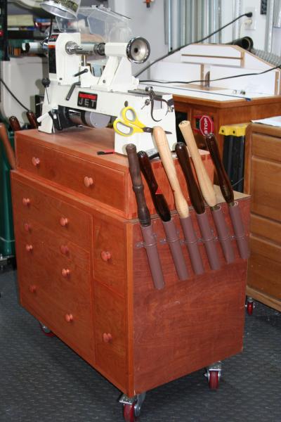

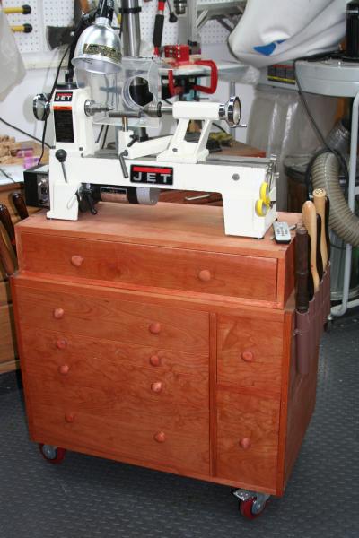

Finally finished the cabinet for the Lathe
See more from GPDMTR25
GPDMTR25
Oct 22, 2008
91
Burbank, CA

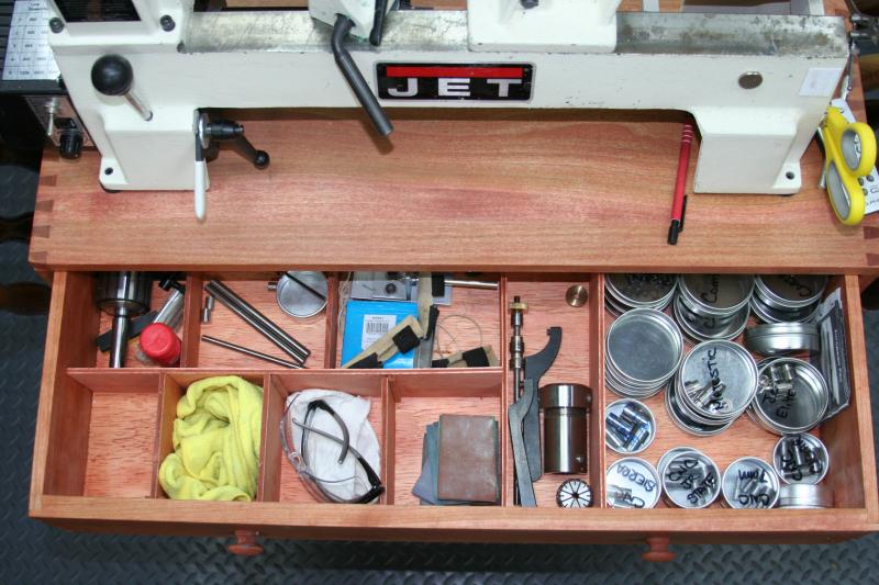

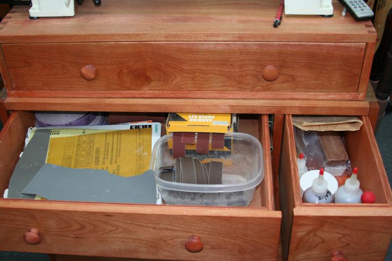

For the longest time I just had the lathe setting on the cabinet body but I finally got around to finishing the drawers. The top box and front of the drawers is made from Cherry wood. Since the top box is solid wood I was able to dovetail the box and half blind dovetail the drawers. The main cabinet is plywood with cherry wood on the drawer fronts. I designed the drawers so the first one holds the sandpaper. I use that the most from the drawers and wanted easy to get at that's why the drawers don't go from small to large. With the top box I added plywood dividers and put the stuff I use all the time.
I'm happy with the results and was glad to be able to do some woodworking again. I'm getting ready for a big event and have been turning and turning pens.
I wasn't going to post this but then I thought someone out there might be looking for ideas for the lathe.
I have the scissors and calipers attached to the side of the lathe with earth magnets. The chisels are in PVC that I screwed into the sides. I just sprayed them brown to look better. They work great. I original had a small wood box on the right side that I used for polish, glue and things but it started filling up with shavings so I took it off when I finished the drawers and put more PVC up. I now keep the glue and things in the drawer on the right.
Thanks
Angela

The empty drawer actually is for a piece of plastic that I put on the lathe when I use water micro mesh, CA, or other stuff like that. I've done about 200 pens on that lathe so far. I've had this lathe for less than a year but love it.
