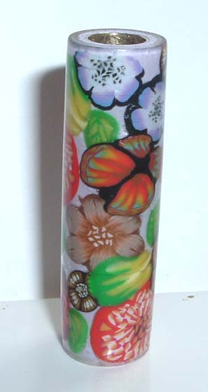

Was finally able to achieve this clear casting with no bubbles.
Earlier attempts with a vacuum setup was disaster!
Credit goes out in large part to the post from 4 years ago by Don Ward in which he related his process to a demo he had seen by Barry Gross.
I was able to create a mold that allows me to rotate the blank while it is in the resin so that I could see and manage the bubbles before it set up.
There is some separation from the base clay at one end. That end was sprayed with a clear lacquer prior to casting. The other end is fine and had 1 coat of thin CA.
Next step is to turn away all of the PR to see how well it sticks to the base and to see how thin I can go with the resin.

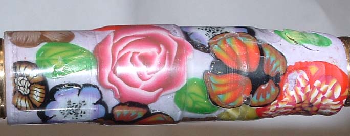

Here is the destructive test of that blank. Sorry but it is toast now!
On 1 end I got too aggressive and went too far. The end that had the CA prep held up better. However, taking the PR down to the clay is not going to be an option so a reconsideration of the clay sizing is now in order.
As I see it, even the PR is not going to make a bond to the PVC clay so it will need to be an encapsulation of sorts.
I had hoped in this test that the PR could be used to fill in the spaces but that won't work!

Am I reading this right that you are unable to get the casting to adhere to the polymer clay?
Not like the adhesion you would get with a dedicated adhesive.
On the latest one, I turned the clay down juyst a bit with a skew and light sanded. Then I pre-painted the clay with the PR and did not use any CA. It looks as though there are very few areas where the PR is not touching the clay. You know, those shinny areas that you can only see when the light strikes it just right.

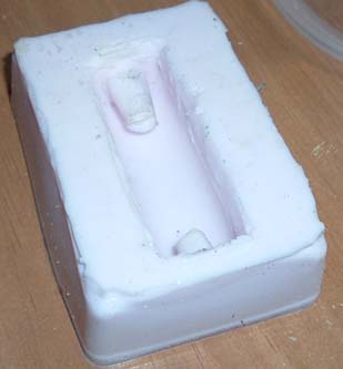

As for the mold, well, I made my own for this next try, pictured below.
It is a rough first attempt but I think it will work. Interesting stuff that #3 RTV mold material.
