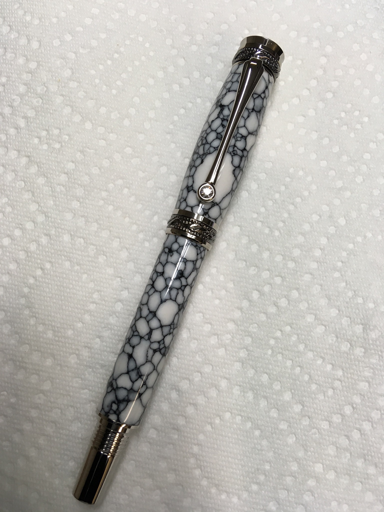

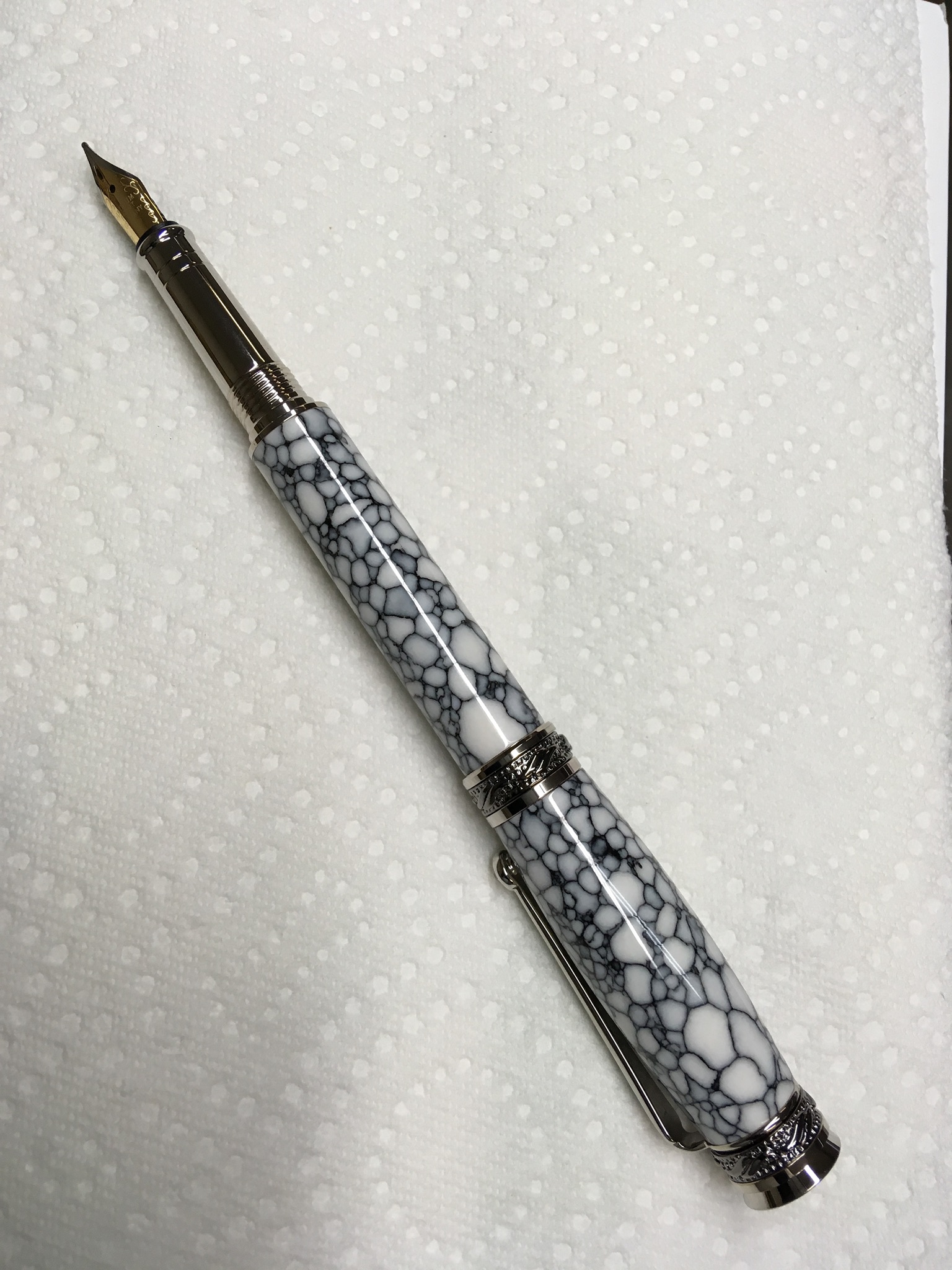

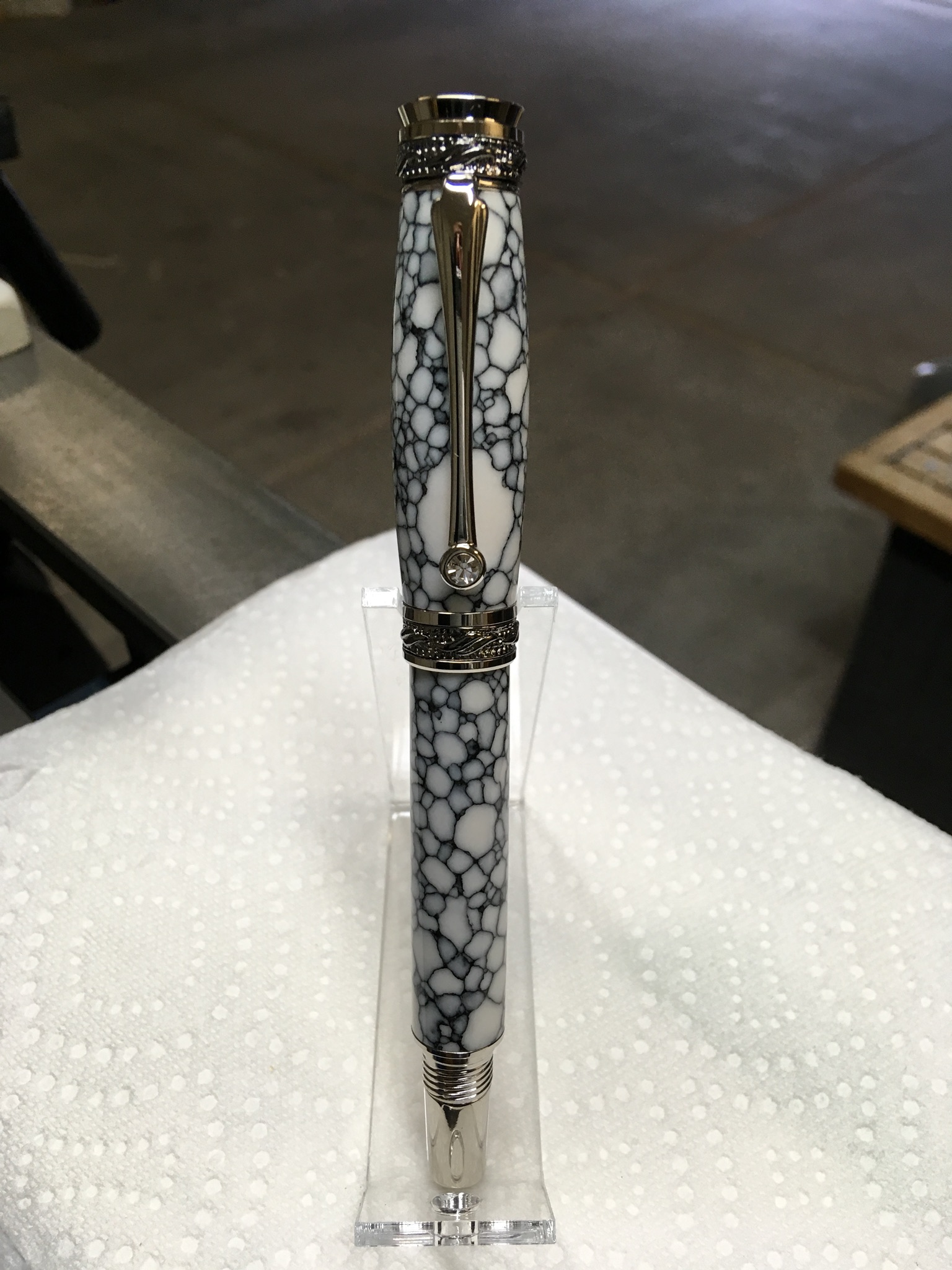

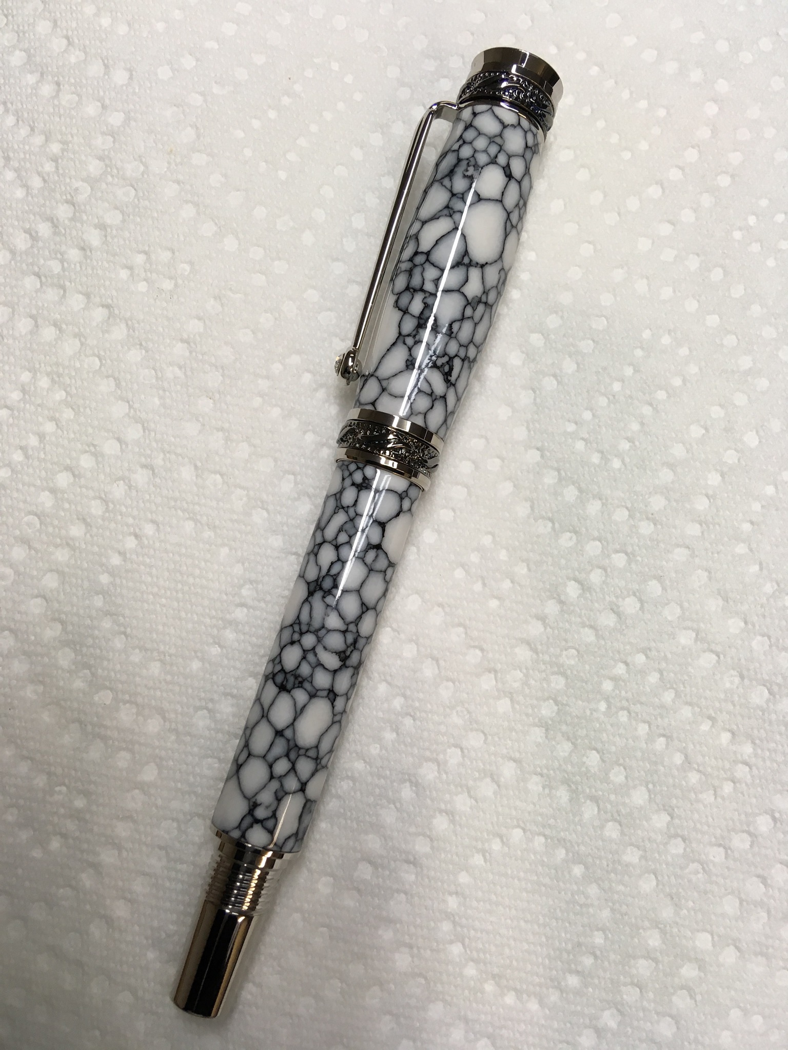

Seems I've been turning a lot of boxes and ornaments the last few months but no pens. I finally got around to making one today, a Majestic Jr FP with TruStone "white with black web" blank. The blank turned easily albeit very slowly. I didn't get quite the totally scratch free shine I usually do, but I'm still happy with it. All comments good or bad welcome. And a special thanks to those who responed so quickly to my other post about backpainting the blank, there was no need to and that meant I could turn it today.

A beautiful pen Jay. I rarely stray from my little wooden sticks, but did so last month.
Your finish looks/sounds like the recent letter openers I turned with trustone. Each came out just fine, but the finish is just "different."
While I have very minute scratches, nothing that the plain eye will see, there are slight high and low spots. Its not out-of-round, just a grain-like effect. I believe these are related to different densities in the colored sections and the webbing. It feels like a wood-grain effect.
I am perfectly happy with mine, but the finished feel is curious. Maybe others can shed some light.
I turned with carbide, wet sanded with abranet 320-600, then wet sanded with micromesh to 12 K, then applied Mcquires's Plastik Polish. Wiped clean between each grit. I'm pleased with the finish, but still has a slight texture to it.

Thanks for the kind replies. This was my first TruStone blank but I'll be making another before Christmas.

The way you described it nails my experience exactly. I get the feeling the black webbing is a different density from the larger white patches. I finished the blank just like you only I used Novus, then buffed with blue rouge. It has a nice shine, but under close examination (I use a 10x magnifying glass) the "rippled" effect becomes more obvious.

Very nice pen! I had a similar experience with the blue TS. All one color basically, but less than "perfect" nonetheless.

A great looking pen!! It's always fun and sometimes nerve wracking to try new material. Great job.
Thank you, and I couldn't agree more. This wasn't anywhere near as tough as I expected so it was fun, unlike my first couple times turning inlace acrylester, which was nerve wracking...
