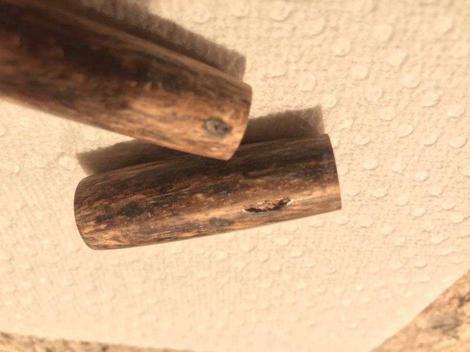

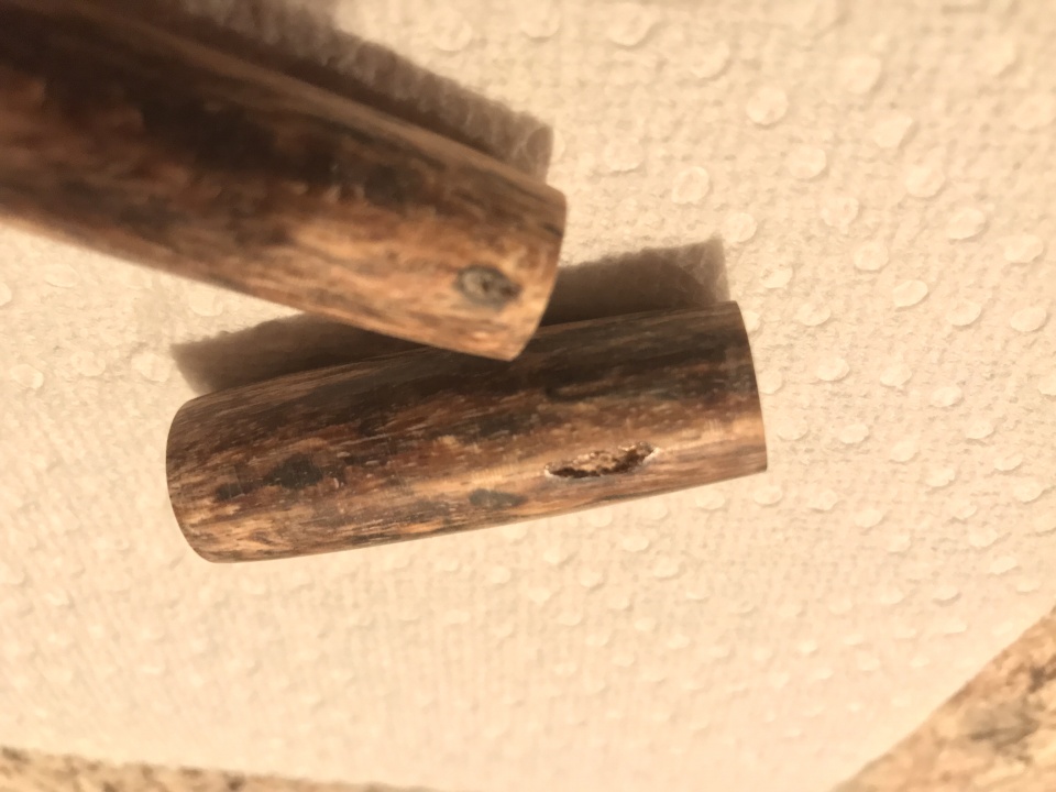

I bought some stabilized spalted Tamarind. After turning them there are a few good sized voids. The sawdust shavings are in my shop vac so I can't use those to fill them. Suggestions? I'll be doing a CA finish afterwards.

Colored sand from Hobby Lobby, Michaels, etc... I sift it through a tea strainer to get very small grains.
I would also scrap/pick out the inclusions to slightly enlarge them, then do your inlay!
This will not look bad! :smile:
