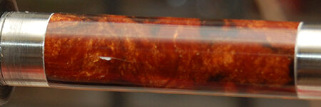

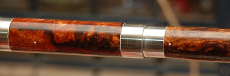

I'm turning an acrylic blank and almost done.
When I was inspecting the pen, I noticed that there are some small holes in the pen. I'm not sure if they were flaws in the original, or some type of nick. Right now they are filled with dust from sanding and show up as white. Also, I have a crack. I assume this happened when I drilled and I just now saw it.
My question is this. Can I just fill and sand smooth? Do I use CA or something else?

I used a little acetone on a paper towel to clean the dust out of the holes. The a little CA will fill them. Then sand again, or if necessary, I little turn with the skew.

Yup , CA will do it . the round holes are most likely bubbles but the crack is chip out , use a very light touch and a sharp skew with acrylics for your finishing cuts . If you hear what Ed Davidson calls "Breaking glass sound" while you are turning the blank you are hearing chip out as the acrylic shatters instead of cutting . That sound is a warning to lighten up on your cuts or sharpen your tools or both .
