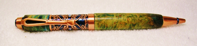

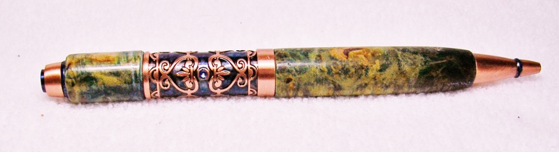

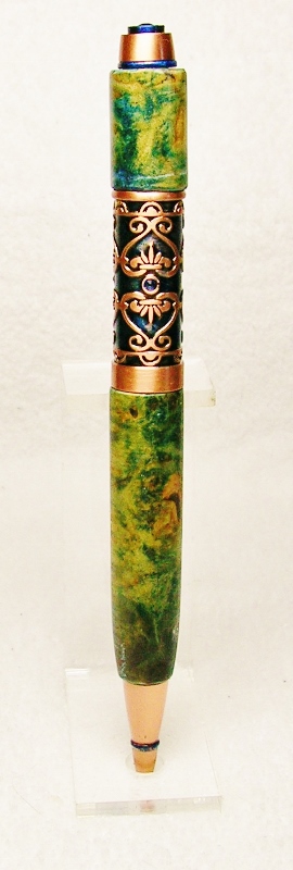

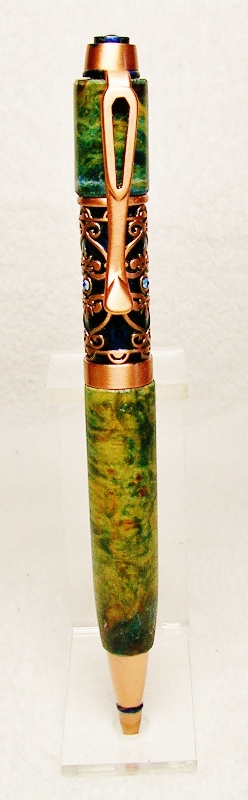

This started out as a PSI Filibella antique copper pen kit. I changed the color of the background and crystals with blue alcohol dye/ink to make the copper design stand out better. The blanks are Birdseye Maple Burl tinted with the same blue alcohol dye/ ink plus a blender to soften the color. With the yellowish grain of the maple and the blue dye, the blanks look more green that blue on the photos. Sanded to 1200 grit and added 8 coats of thick CA. Re-sanded to 1200 and applied Nova #1 and #2 Polish. In my humble outlook this pen kit, without enhancement, is one of the most unflattering in the PSI collection. That is the reason I ordered this kit, to see if I could improve on it's looks. Hope this gives some of you out there ideas of what can be done with it. You can be the judge as to if it improved the look or not. Feel free to blast away !! Jim S

Definitely looks nicer than the original kit. The fit could be more even with the trim however the copper and blank match well.

Jack; The crystals are the clear ones that came with the kit, I just used alcohol ink to dye them blue. When I add crystals to a pen I use thick CA to hold them in place. Jim S

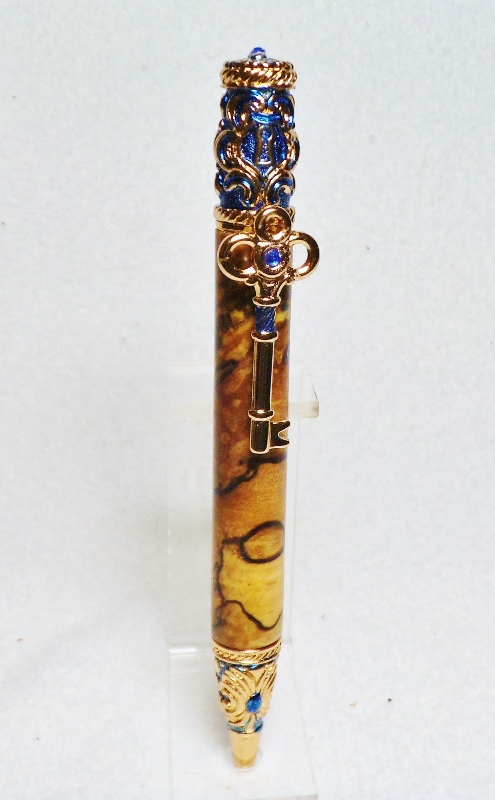

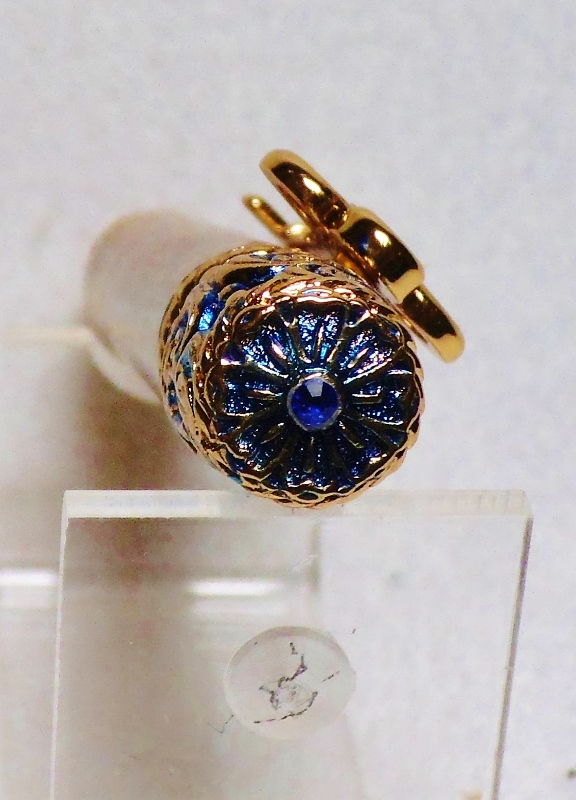

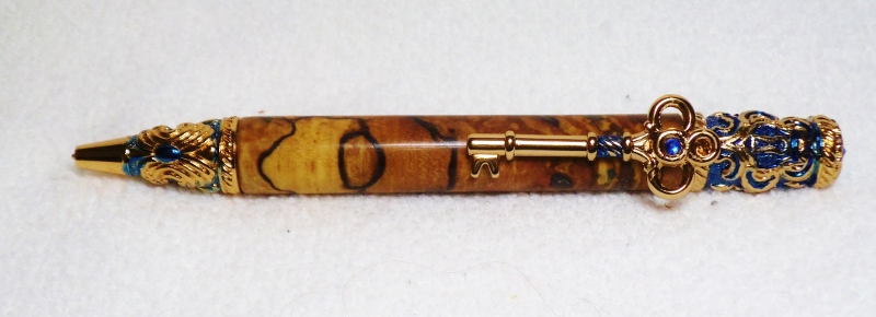

Jack; Here are a few photos of a skeleton key pen that I have blinged up. On this one I added blue crystals and alcohol ink. Hope this helps. Jim S

Thank you Jim, I remember seeing and liking it when you posted it initially. Thought then that it was really nice looking. The client wanted "rhinestones" and I think she liked the shiny gold, so I think I am going to fit 8 small crystals in the finial, the one in the center of the key, and a couple on the nib section. She wants the same treatment on an AP Victorian Rollerball. It's going to be a little tough finding places to put them on that pen without having to mill some flat spots. Wish me luck, I think I'm going to need it.
