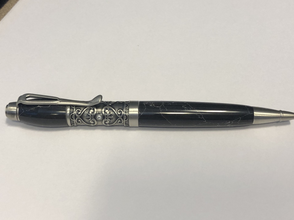

Here is a Filibella done in Penn Stone Black and White Matrix. The key to these is to take your time and make sure the inside of the tubes are as clean as possible when insterting the tip etc. as it will crack. Stone is not very forgiving.
No issues with this one as I have learned from my past experiences.
