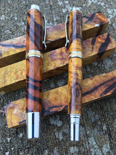

One other thing I wanted to comment on and a "soap box" of sorts in the woodworking field. I am not the best at this but I have noticed that the "average" woodworker and pen turner who do things for sale - spend more of their time in crafting/making than in finish. A mediocre blank will do well dressed in a finely polished finish. I usually spend as much time on the finish as the construction. At the point of sale, the finish is the presentation of the artistry and material under it.
Look at these pens that I picked out at random from the front page:
Look at the reflective light band on these two pens below this comment:
http://www.penturners.org/photos/images/12678/1_firewhatfire.jpg
The reflective band show how well it has been finished. (A ceiling fluorescent light diffuser can mess up good photos). Some pen makers despise the look as "plastic like", but buyers see it as refined finish and quality of the maker. This adds to the value immensely.

This pen, it doesn't have to have a sheen on it, but the time spent in finishing - whether matte, sheen or shine, - greatly increase the potential for sales. And this should be counted into the price.

Lee, it is interesting that you bring up the concept of finish. My acrylic pens are all polished to a high shine. Over the last several years I've adopted a finish of simple wax on my wood pens. My first several wood pens I did several layers of CA and polished it to a shine. Most of those were given to friends/relatives so I got to see them after they'd been used. I discovered that on a lot of them the CA eventually dulled from use. On my personal early pens the CA finish got marked, etc from being used,, stuck in my bag, etc. So far at least the customers I have had who pick a wood blank want the wax. Aside from it is easier for me to do and takes less time, IMO it pops the grain much better than a high shine. I realize that with some open grained woods a CA finish would be preferable.
